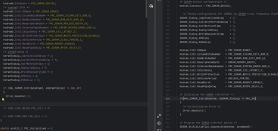

Having been stuck with problem #1 for a few hours I decided to to try load the frame buffer in external RAM, that also did not work. I have an even smaller understanding of the FMC then the LTDC. I set it up with the values used in the GFX generated .ioc plus set up the block in the memory management tool but my debugger was unable to access the location, nor was code able to interact with the memory location without a hard fault.

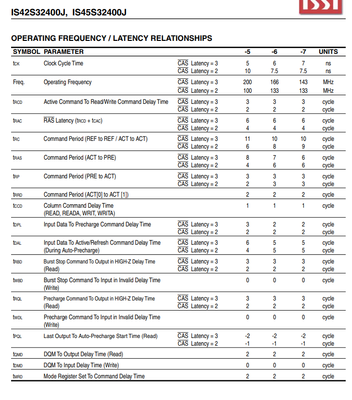

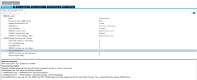

My guess here is timing issues so I had a look at the datasheet (IS42S32400J-6B) and MX example, the only thing that stood out to me was that the Write Recovery timings were different, but in a way that cubeMX says is incorrect.
CubeMX says that RowCycleDelay - RowToColumnDelay - RowPrechargeDelay <= WriteRecoveryTime, however the example provided by CubeMX does not respect that, unless I've made a mistake somewhere? I've looked at the timings in datasheet for the IS42S32400J-6B. Those timings confused me even more, I'm unsure what some of the timing parameters are because they use slightly different names.

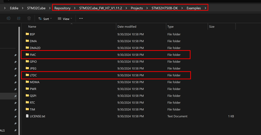

I suggest looking at simpler examples in the Repository folder of your installation for guidance.

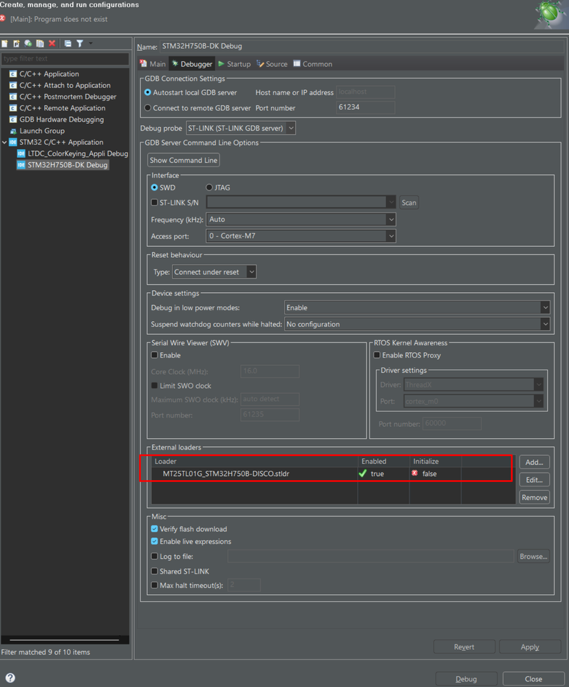

So we have the concept of External loaders. If you selected the proper board as the base for the Designer project, the STM32CubeIDE project it generates should have it preconfigured to use the external loader as seen below in the debug configurations:
If it is not there then click add and find that external loader.
Optionally you could load a preexisting demo or example based on the same board and check out its settings.
