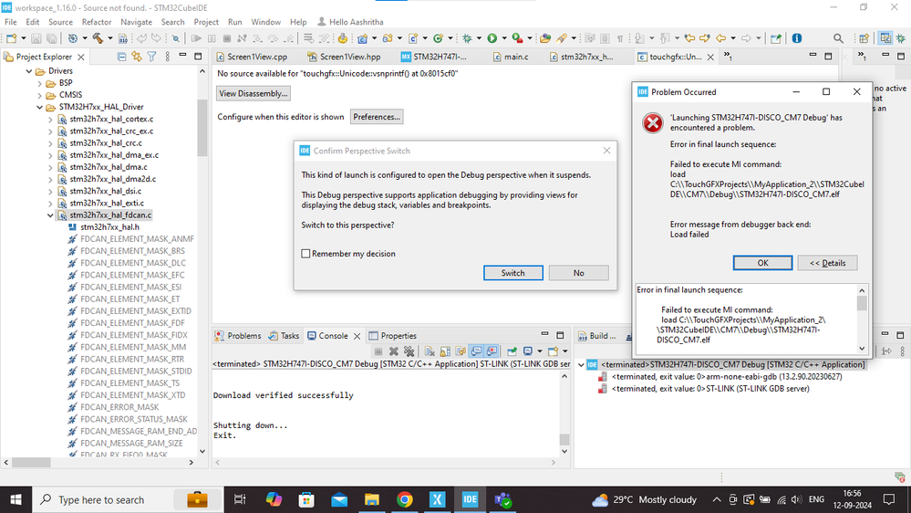

I am currently working with the STM32H747XIH6 board and encountering an issue where programming and running the target fails, even though the simulation in TouchGFX works perfectly.
Here are the details of my setup and the problems encountered:

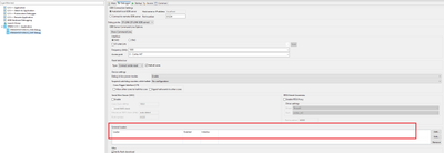

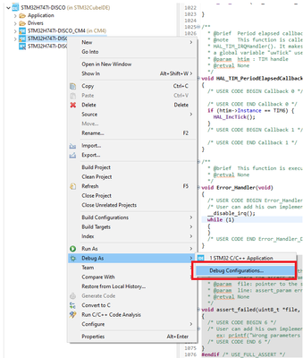

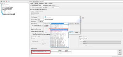

The External Flash loader is not set in the debugger menu.
You need to select the adequate FlashLoader for the External QSPI NOR Flash:
