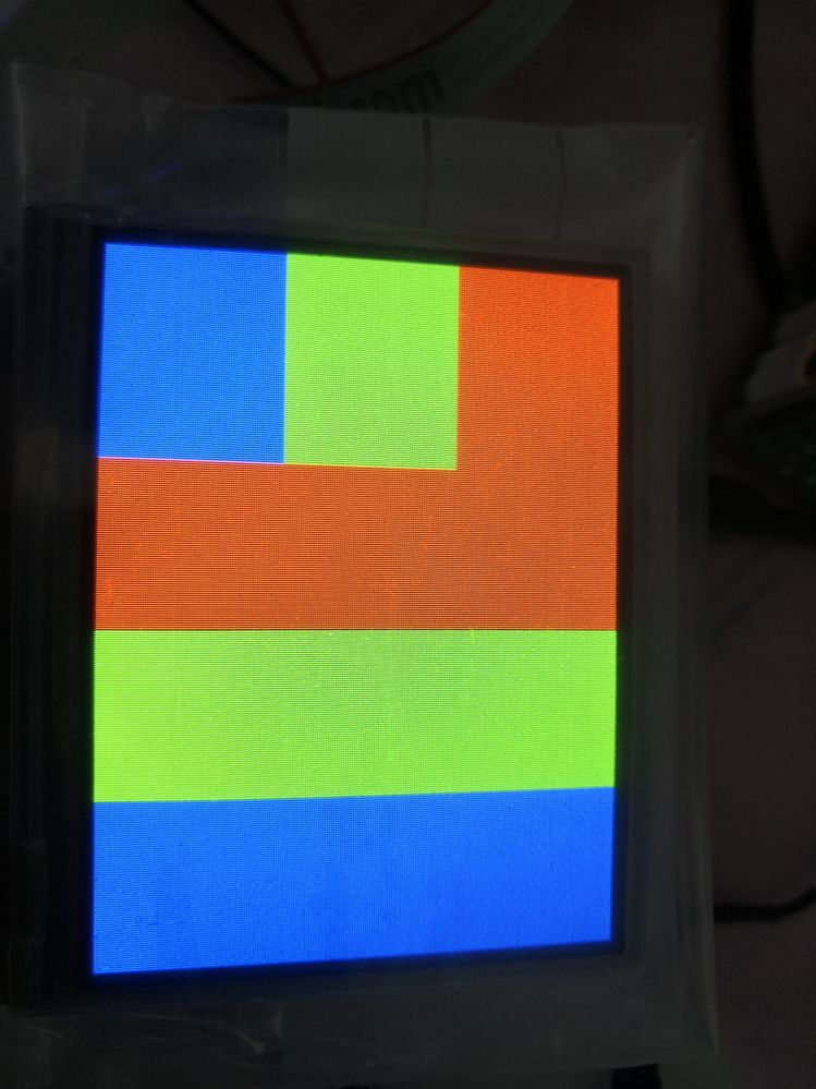

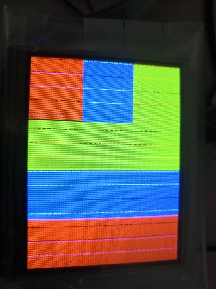

I am integrating TouchGFX on custom board (STM32F767II) with external SDRAM (AS4C16M16SA).
The issue I am trying to solve is the color swapping with external SDRAM. When the internal RAM is used the colors are displayed correct.
I have attached two pictures :
I have also attached the CubeMX file.
Does anyone have an idea how to solve this?
Regards
Dejan

2019-07-02 12:42 AM
Hi @Dejan Nedeljkovic,
That looks strange. Can you verify that the contents of the framebuffer when in internal RAM is the same as when it is in external sdram?
Thanks!
