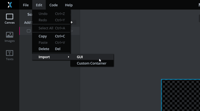

Hello @botta ,
When switching to a new MCU, you need to adapt your hardware. It is not only about the MCU, but also the screen, memory, etc.
Now, regarding the UI, if you made a UI, you can import it to another TouchGFX project by clicking on Edit>Import>GUI :
Regards,

Hello @botta ,
Regards,
