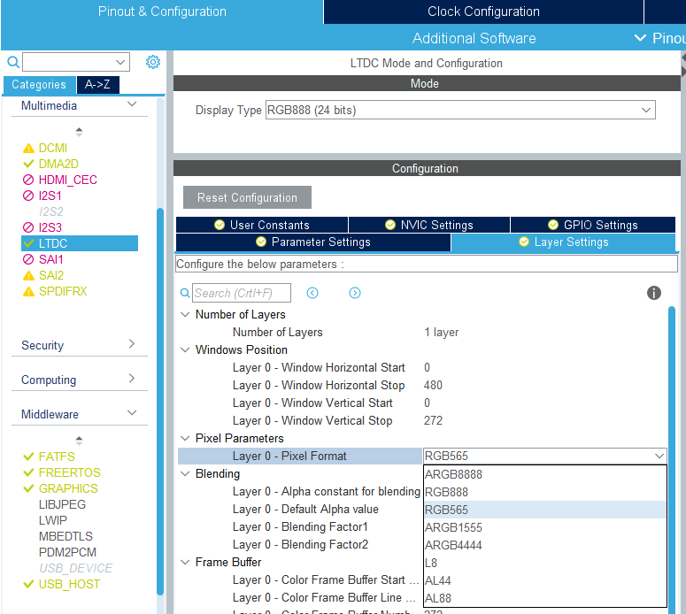

I assumed it was the LTDC Display Type, but when changing that, the TouchGFX Color Frame Buffer Depth did not change.
However, when I changed the LTDC > Layer Settings > Pixel Parameters, it did effect the TouchGFX Color Frame Buffer Depth. I show it below for other people's reference:
LTDC Pixel Parameters:

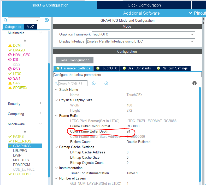

Change reflected in TouchGFX Color Frame Buffer Depth:
I also found that this does automatically alter the TouchGFX BoardConfiguration.cpp file as well (which is very helpful).
