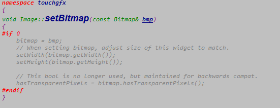

2019-09-16 6:51 PM
The code I edited is not wrong, it can be built successfully.
I added a log, but this log is not output when the project is running.
void Image::setBitmap(const Bitmap& bmp)
printf("Enter the setBitmap function. \n");
bitmap = bmp;
// When setting bitmap, adjust size of this widget to match.
setWidth(bitmap.getWidth());
setHeight(bitmap.getHeight());
// This bool is no longer used, but maintained for backwards compat.
hasTransparentPixels = bitmap.hasTransparentPixels();
}And I remove all code from this function, all images still display normally.
}So I think the only possibility is that this function has not been called. And the strange thing is, this function is indeed linked to my app.
