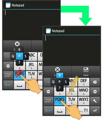

I want to realize character input by flick operation like a smartphone, but I can't find it on the demo screen.

I don't think it's too complicated to create and it doesn't necessarily require extra button. This should be doable by getting the gesture event coordinates.
(source : https://k-tai.sharp.co.jp/support/w/wx04sh/manual/online/en/en_cont/02_5_wx04sh.html#a1)
In the example above, pressing the "7" button will allow you to enter "R" if you swipe up, "S" if you swipe right, "Q" if you swipe left, "7" if you swipe down, and finally "P" if you release your press (behaves as a click).
So you'll only need to know which direction you'll swipe and based on that you can know which characters it corresponds to.
