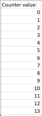

I would like to display a counter that goes from 0 to 255 on a scroll wheel but what I get is the exact same value on each row of the scroll updating in real time. What I want is each counter value displayed on each row, e.g
