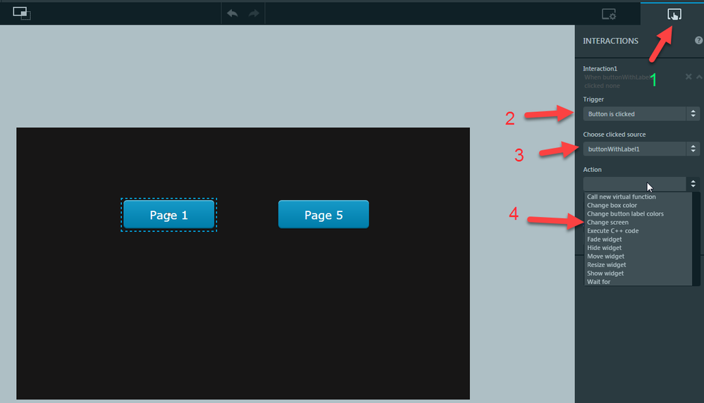

2019-04-03 5:00 PM
I think I understand what you are after.
1) Add a button.
2) Select the button.
3) Follow this screen to map a function to the selected button:
Post back if this is not correct and misunderstood your request. Hope this helps.
