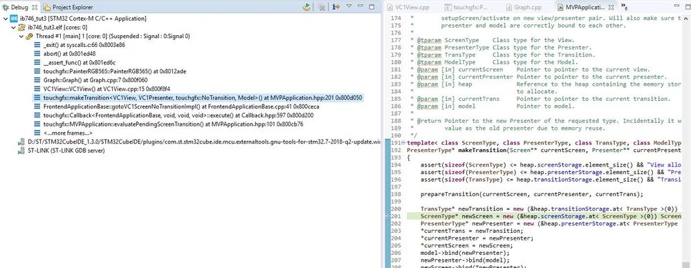

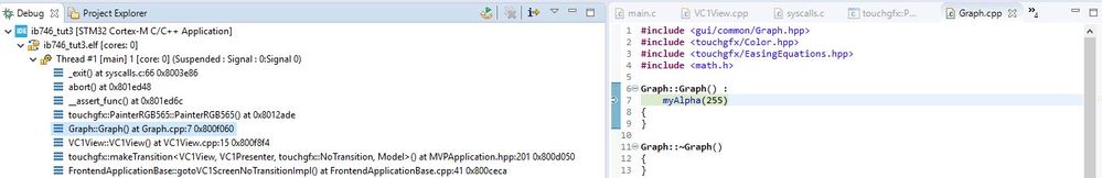

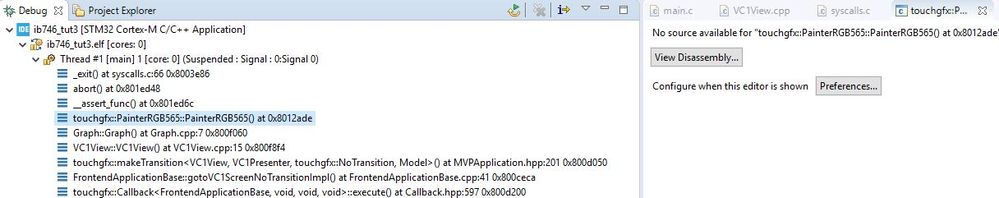

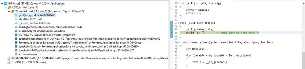

here the screen shot from debugger when application ""crashed"
Tracing it back:
While was typing I was thinking should I place any canvases or any other "UI elements" on screen while generating tuch GFX project?
Anything else I can provide you with? Please advise...
Thank you for all the support
Regards,
IB
2020-04-14 10:46 PM
Hi
Did you adapt the painter to your system?
I had a similar behaviour and then I changed from PainterRGB565 to PainterRGB888 in Graph.hpp.
It depends on your TouchGFX settings which painter class to use.
Regards
Dejan
2020-04-14 11:26 PM
This is also a very good point. The LCD class will assert if the format is not correct. People tend to copy the Graph from project to project without considering the pixel format.
/Martin

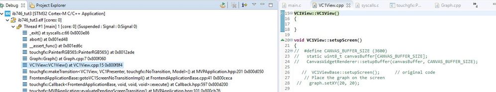

Hi @Martin KJELDSEN @Dejan Nedeljkovic
This is definitely helps and I can see simple graph on the screen... Thank you for all your help.
Question what I have, how would you recommend to declare frame buffer without modifying "generated" files (TouchGFXConfiguration.cpp)
ie
void touchgfx_init()
Bitmap::registerBitmapDatabase(BitmapDatabase::getInstance(), BitmapDatabase::getInstanceSize());
TypedText::registerTexts(&texts);
Texts::setLanguage(0);
FontManager::setFontProvider(&fontProvider);
FrontendHeap& heap = FrontendHeap::getInstance();
(void)heap; // we need to obtain the reference above to initialize the frontend heap.
hal.initialize();
#define CANVAS_BUFFER_SIZE (3600)
static uint8_t canvasBuffer[CANVAS_BUFFER_SIZE];
CanvasWidgetRenderer::setupBuffer(canvasBuffer, CANVAS_BUFFER_SIZE);
}Thank you very much for all your help and support.
Regards,
IB
2020-04-15 7:29 AM
You can set the canvas buffer size in TouchGFX.
Select the Screen where your graph should be drawn and then you can set the canvas buffer to another value:
2020-04-15 7:41 AM
You can also write any code you want inside TouchGFXHAL.cpp (it inherits from HAL and also has initialize() )
2020-04-15 7:44 AM
