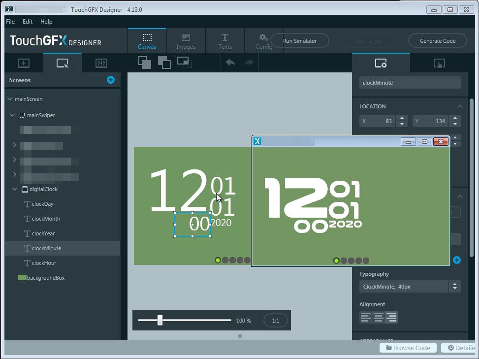

I've came across a weird bug, where Designer displays a completely different font in the design window than is selected in the Typography . On compilation (emulator or on device) appropriate font is displayed. Example:
As you can imagine, sizing and placing of text elements is extremely annoying.

Just tested it, you apparently found a font file that we cant handle within Designer :grinning_face_with_sweat: I also tried to download it and see if it was recognize as a font installed in Windows but still could not find it. I talked to a colleague who will have a look, but it is mainly bad luck for now, I guess you could try to work wihtin Designer with a look alike font to do the settings but this might be complicated for nothing. Good luck :|

In addition to this, there is another frustrating issue with the Designer. The Designer doesn't place the text in the same location that the generated and/or simulated code does. Having to constantly simulate to verify exact location of the text is quite cumbersome.

I am having the same issue. As @scottSD stated, constant simulation is necessary to check if the fonts have the correct location on the screen. Without any observation of screen shown by the simulator this makes it nearly impossible to place the texts correctly.
Would be great if this gets fixed. Thanks.
