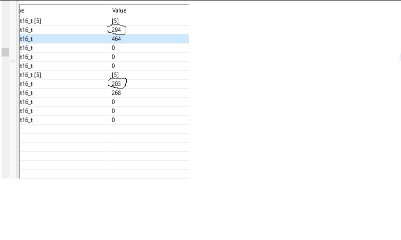

2022-09-21 1:21 AM
the coordination is accurate equal to button coordinates in touchgfx.
if it trig with worst coordinate why it change the button picture?
