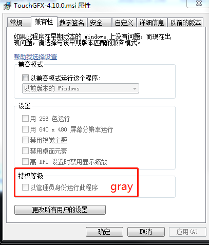

Perhaps you need ADMINISTRATIVE rights to install this program?
2019-01-01 5:28 PM
ADMINISTRATIVE rights to install are also failed!

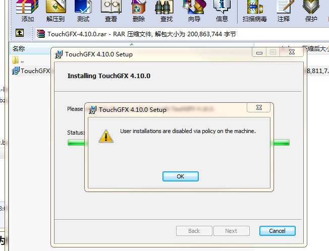

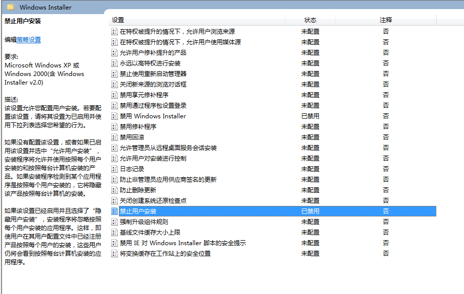

Do you have an IT department that can answer questions about the policies governing this machine? Some policy is obviously preventing installation and it's very specific about "User installations" which would imply something more general.
