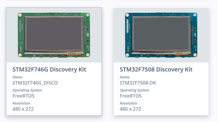

As I asked before, I have a problem with the LCD touch not working due to the version problem of the stm32f746-disco board.
By the way, in ToughGFX designer, select the stm32f7508-disco with the same PCB appearance, create a project, and write on the stm32f746-disco, and the touch works well.
-> touchGFX designer project = stm32f7508-disc
->Use target board = stm32f746-disco
=> operate normally
Will there be any other problems if I use the stm32f7508-disc-based project in touchGFX designer with stm32f746-disco as the target board?
