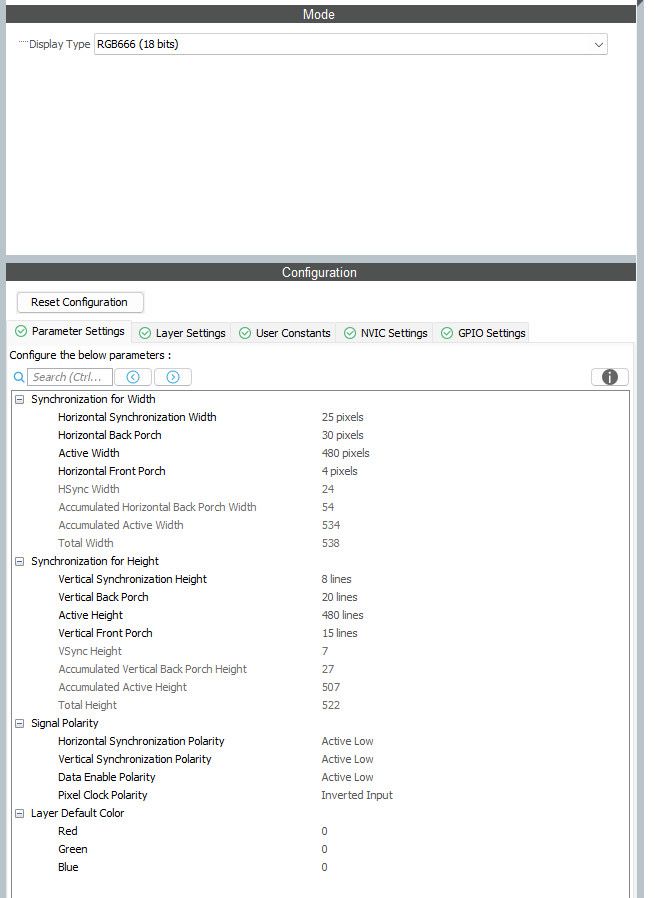

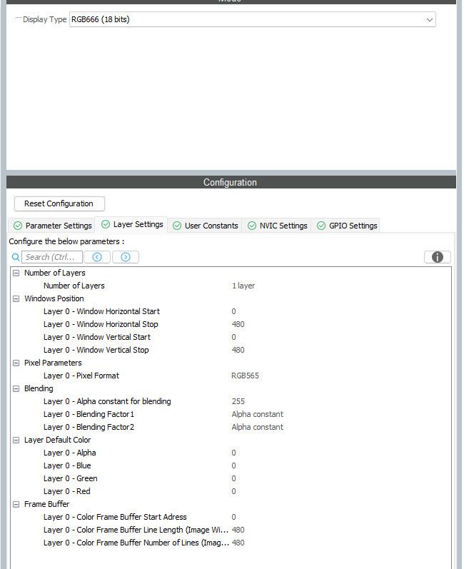

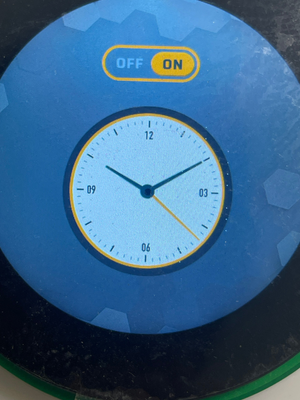

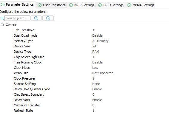

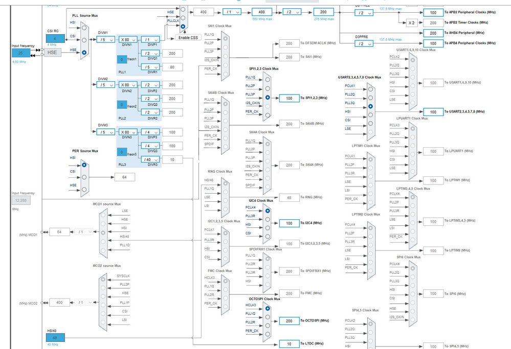

Hi all,
As title, I have a custom board using STM32H723ZGT6, RGB666 LCD (480 * 480) with LTDC interface, the framebuffer used external Octo SPI PSRAM APS12808L-3OBM-BA of APMemory. I can display image using TouchGFX, but the image always noisy with some green pixels ramdom, I try with others image, but it still appear (see image)Untitled.jpg
Below is my configuration for system clock, OSPI, LTDC
APS12808APS12808LTDCLTDCRGB LCDRGB LCDSystem clockSystem clock

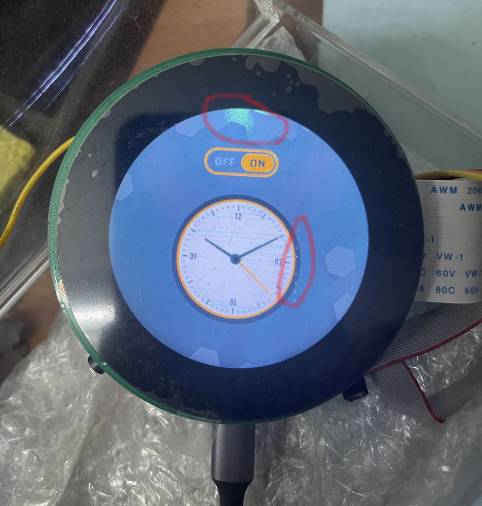

The good news
I tried as you recommended in the link above: adding a 120-ohm resistor to the CLK and RWDS pins of the PSRAM. The green pixels are no longer appearing (although there are still some white pixels in a line, but this problem is really solved) (see image below). Once again, I am very grateful for your help! :smiling_face_with_smiling_eyes:
P/S: I have a question. Can you help me with it? I referred to the schematic of the STM32H735-DK board provided by ST, and they did not add any resistors to the OSPI pins (or later updates did not mention the fix). However, it seems that this green pixel error does not appear on their LCD. Why might that be?
