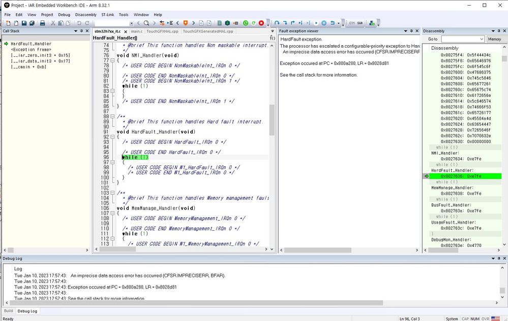

I want to use the touchgfx video widget for my STM32H743II custom board.
The custom board has completed image upload verification with Touchgfx.
I set it according to the Touchgfx video decoding.
I tried to execute it, but an error occurs.
A hard fault error occurs before entering the main loop.

Hello LSoo.2,
Could be multiple reasons for that. You can use STM32F769-Disco, STM32H750B-Disco and
STM32F746-Disco TBSs available on TouchGFX Designer as reference and try to compare your project with these ones.
My advice : I would start looking on the linker script :)
