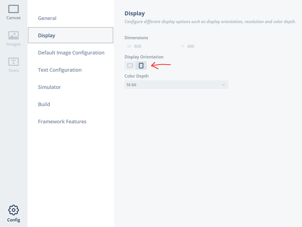

Within TouchGFX Designer you can set the display orientation to either Landscape or Portrait mode, so a 90degree rotation. To do so, go to the Config tab in the bottom left of TouchGFX Designer and go to the Display section.
Otherwise you can do this as you said within STM32CubeMX where you set the display to 480*800.

What option did you use to rotate 90 degrees in the end ?
TouchGFX->Config->Display->Display Orientation
