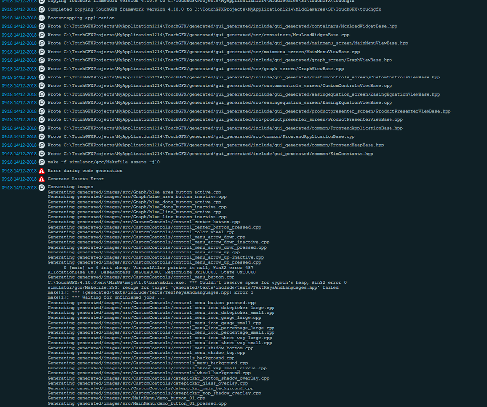

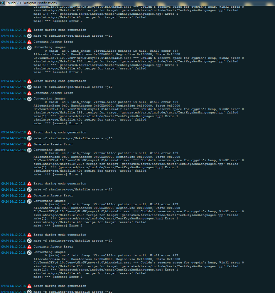

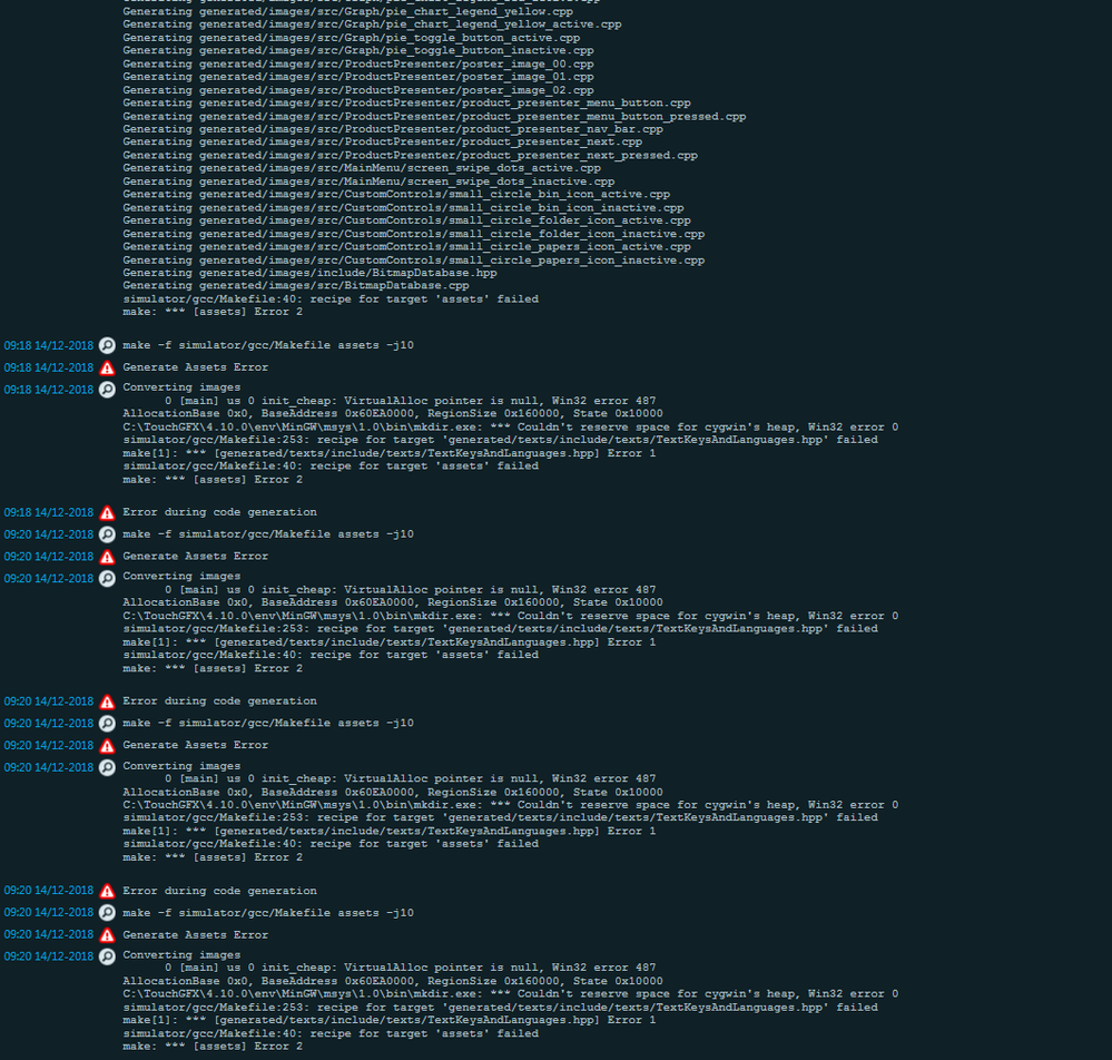

I will contact you with an unknown error.
When this error message is displayed, the run simulator, run tag, generater code, etc. can not be executed.

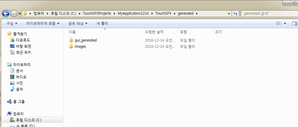

I noticed that some of the code in the 'generated' folder should be missing.
Please tell me how to fix it.
Below is an error message.
