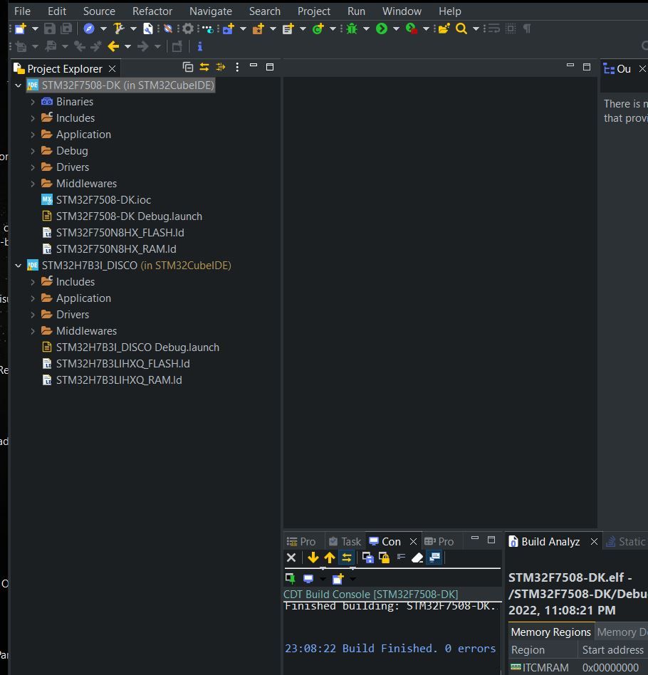

2022-05-07 2:20 AM
It works, thank you. But every TouchGFX project is generated with the default name "STM32H7B3I-DK". If I want to generate another project and import in STM32CubeIde, a warning to replace the old project appears. Any idea to have more than a project in workspace?
2022-05-07 2:23 AM
2022-05-09 1:11 AM
This is a known issue, it's on our table. Meantime, I invite you to create a new workspace for your project, or remove your old project from your workspace.
