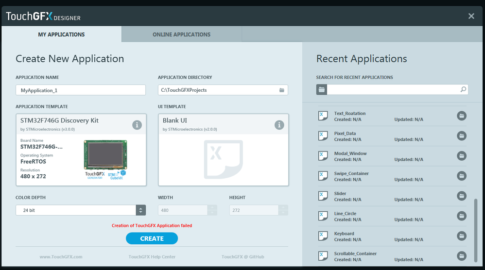

Since, Last 1.5 months i am working with TouchGFX.
I am getting error like "Creation of TouchGFX Application failed" while click on "CREATE" button.

Hi @Community member,
Please download the newest version of TouchGFX Designer (At the time of writing it is 4.13.0), this should fix the issues for Application Templates of version 3.0.0

2020-01-09 12:56 AM
There's an issue with older versions of TouchGFX Designer being able to access Application Templates that are incompatible for that version. While the information for these new application templates reflect the appropriate version you'll still be able to "CREATE" and fail.
If you update to 4.13.0, as Anders mentions, you'll also be able to open this project in CubeMX 5.5.0 and use the new TouchGFX Generator to customize your HAL.

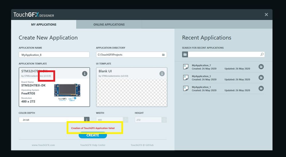

setup on Windows 10
TouchGFX 4.12.3 Designer
Hi to all, anyone can help me?

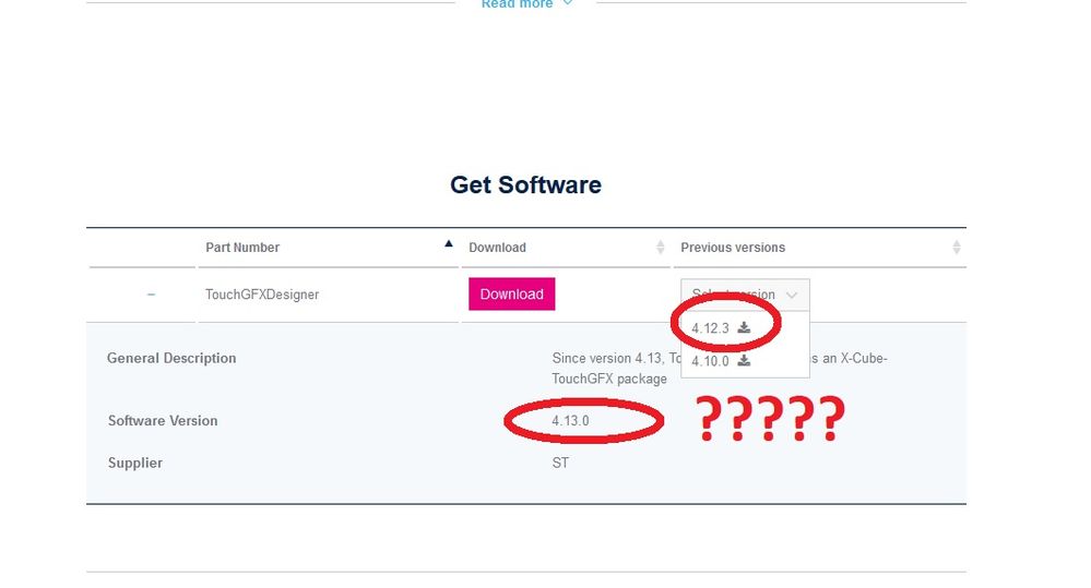

I don't understand your highlighting - "Previous versions" do not include the "current" version.
Please show me a log file %APPDATA%/TouchGFX-4.13.0/TouchGFXDesigner.log

Hi Martin, thanks for your answer.
I solved it by installing the TouchGFX-4.13.0.msi version, this version are only present in en.x-cube-touchgfx.zip package.
