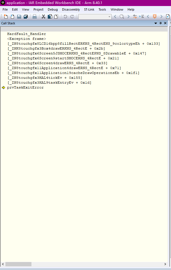

Hi Martin@Martin KJELDSEN :
How to use it without DMA2D?And I can't understand how to use HAL::flushFrameBuffer(r); in my project.@Martin KJELDSEN
#define HAL_CLASS_TYPE MyHAL
HAL& hal = touchgfx_generic_init<HAL_CLASS_TYPE>(dma, display, tc, GUI_DISPLAY_WIDTH, GUI_DISPLAY_HEIGHT, (uint16_t*)dynBitmapsBuffer, DYN_SIZE, MAX_DYN_COVERS);Is this the right way to use it?I use HAL_SPI_Transmit_DMA(&hspi1, (uint8_t *)pimage, 240*240) to send image,so can I use thisway to send farmbuffer
to screen?
Best regards!
Jack li

Hi Martin@Martin KJELDSEN (ST Employee) :
How should I solve it?????Thanks very much !!!!!!
Best regards!
Jack li
