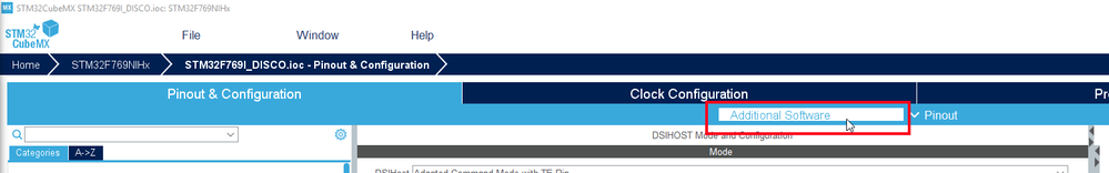

The X-Cube-TouchGFX is treated as an "Additional Software" Component by CubeMX and therefore needs to be "Added" to the project before it is usable.
This is done by click on the "Additional Software" button (See image below)

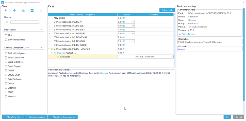

In the Additional Software Components selection window, browse to STMicroelectronics.X-CUBE-TOUCHGFX and under Application select TouchGFX Generator.
Now you should have an "Additional Software" tab in the Categories section of CubeMX.

2020-01-07 11:27 PM
