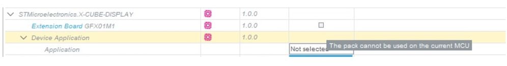

GFX01M1 declare that is compatible with NUCLEO-F401RE, but CubeMX say that X-CUBE-DISPLAY cannot be used with thic MCU... It would be nice to clarify what is being stated.

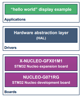

Backing to X-CUBE-DISPLAY Data brief, the X-CUBE-DISPLAY STM32Cube Expansion Package supports the QVGA X-NUCLEO-GFX01M1 STM32 Nucleo expansion board combined with the NUCLEO-G071RB STM32 Nucleo development board.
0693W00000CzkuUQAR.pngCurrently the X-CUBE-DISPLAY STM32Cube Expansion Package includes an STM32CubeMX configuration project for only NUCLEO-G071RB with a simple “hello world�? application. It does not cover all other Nucleo boards compatible with X-NUCLEO-GFX01M1. Hence, it is greyed out for other supported STM32 Nucleo boards and cannot be enabled through STM32CubeMX interface > Software Packs Component Selector window:
0693W00000CzkuZQAR.jpgNevertheless, for other compatible boards, you can mimic the generated STM32CubeMX project using NUCLEO-G071RB and X-CUBE-DISPLAY expansion package and adapt the code accordingly.
