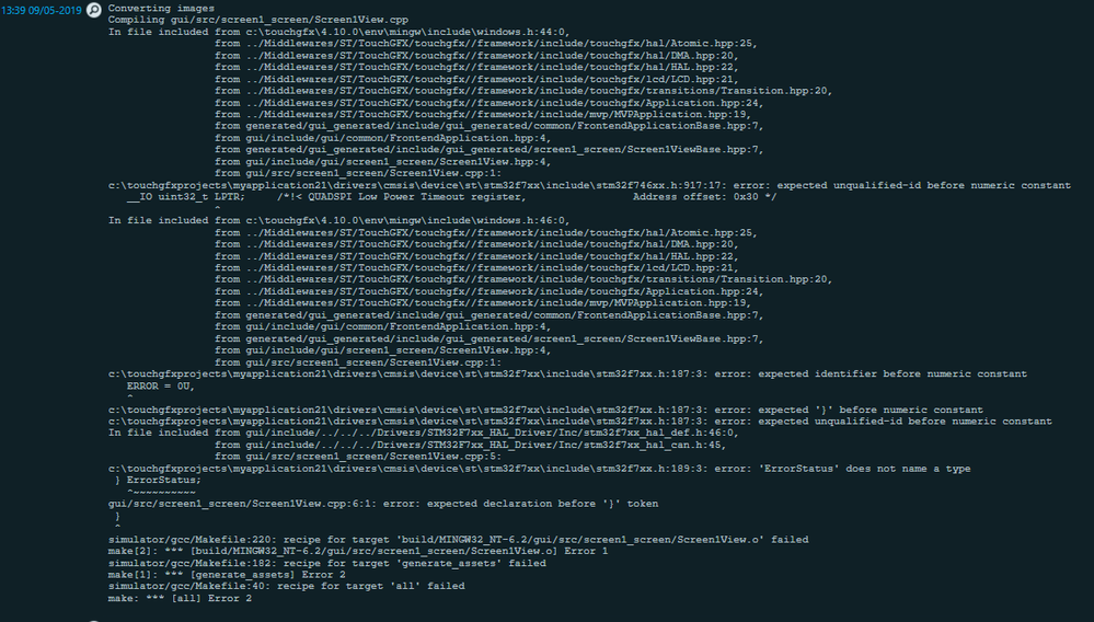

2019-05-09 5:44 AM
Hi Martin, I still have the same issue for including the stm32f7xx_hal_can.h library to my Touchgfx Project. I have tried to manually edit the paths of the include and I could get some progress in the includes. However, at one point I have this issue
I also tried to add an include path in the mainfile: include_paths := $(library_includes) $(foreach comp, $(all_components), $(comp)/include) $(framework_includes) Drivers/CMSIS/Device/ST/STM32F7xx/Include
but I still have that error:
In file included from gui/src/model/../../../../Drivers/STM32F7xx_HAL_Driver/Inc/stm32f7xx_hal_can.h:45:0,
from gui/src/model/Model.cpp:3:
gui/src/model/../../../../Drivers/STM32F7xx_HAL_Driver/Inc/stm32f7xx_hal_def.h:46:23: fatal error: stm32f7xx.h: No such file or directory
#include "stm32f7xx.h"
Maybe it has to do that the HAL CAN library is not supposed to work with the simulator?
