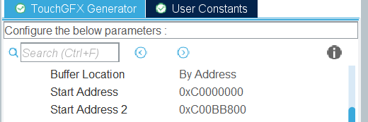

I have changed the "Start Address 2" by adding 16x480x800/8 to the "Start Address" I'm using RGB565 as in the Application template that's why it is 16, not 24. (But I tried using 24 and RGB888 configuration as well. But it also had that same issue.)

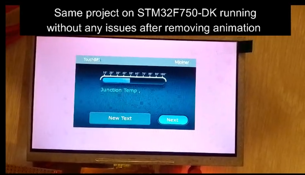

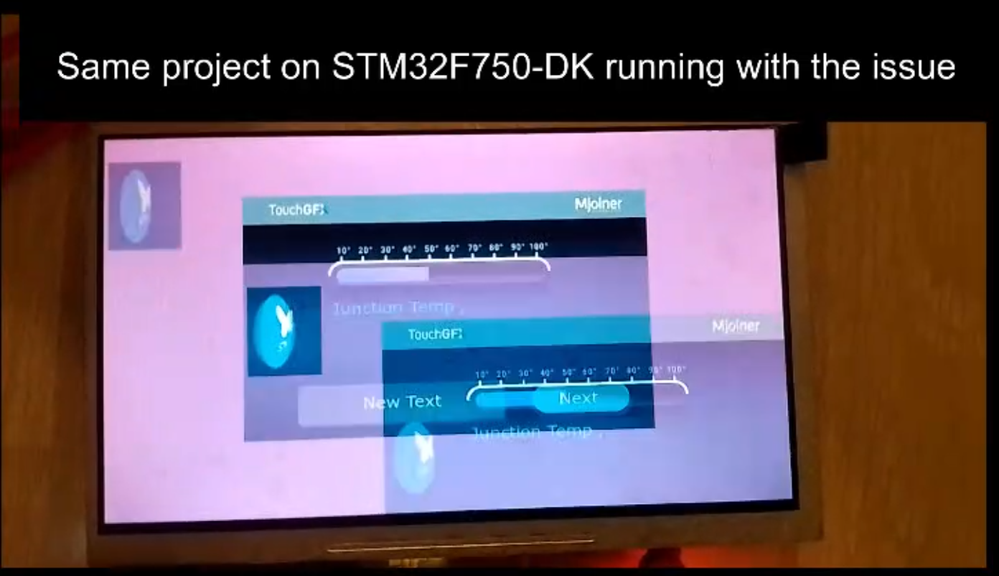

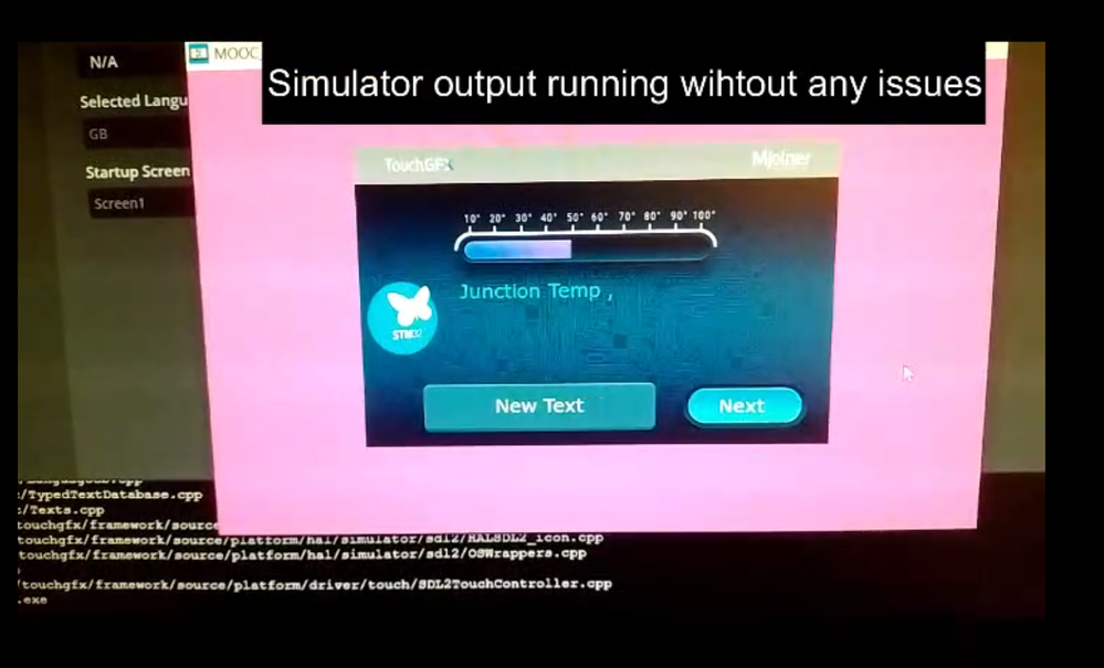

Finally I was able to drive static screens. But the problem is when something change in the display, display is shaking(objects are moving here and there). For better clarity I have attached the video
I have pasted screenshots as well
From the TouchGFX designer I just only put pink box as backgound to fill the area.
Same issue happens when change between 2 static screens without any transition animation as well. But after the screen changed it shows without any issue. Issue happens only at the moment of changing (Since animattion changes continously issue exist continuously as in the video)
I have attached my CubeMX file as well

I compared them using git. Notice that LTDC configuration in main.c and TouchGFXConfiguration.cpp files has been changed by the CubeMX accordingly. But that's it. It does not contain any FMC, SDRAM related configuration changes
