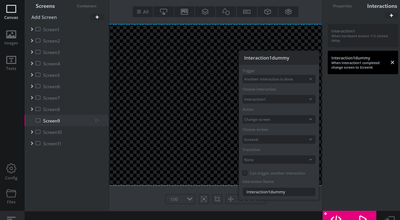

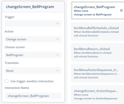

If the gotoScreen[...]-functions are not created by TouchGFX Designer, add an Interaction without trigger and action for change screen and then it will:
2023-07-02 11:41 PM
if you generate the code according to above settings goto[..] function will get created in generated folder.
check FrontendApplicationBase.cpp file there you'll get yours goto... function for screen

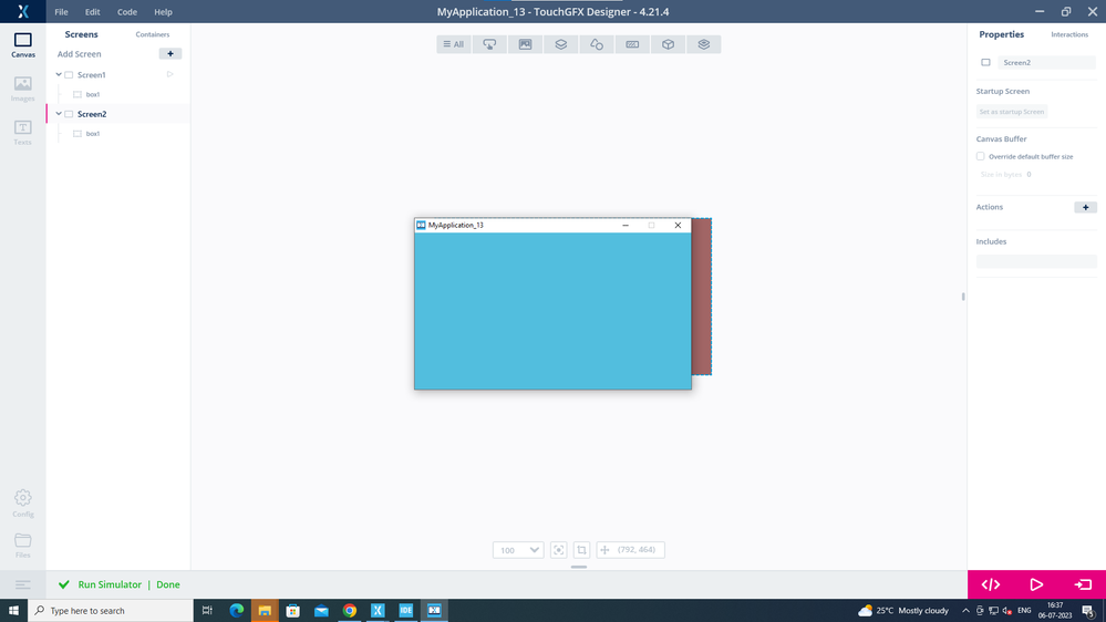

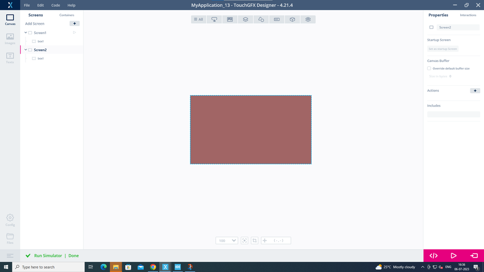

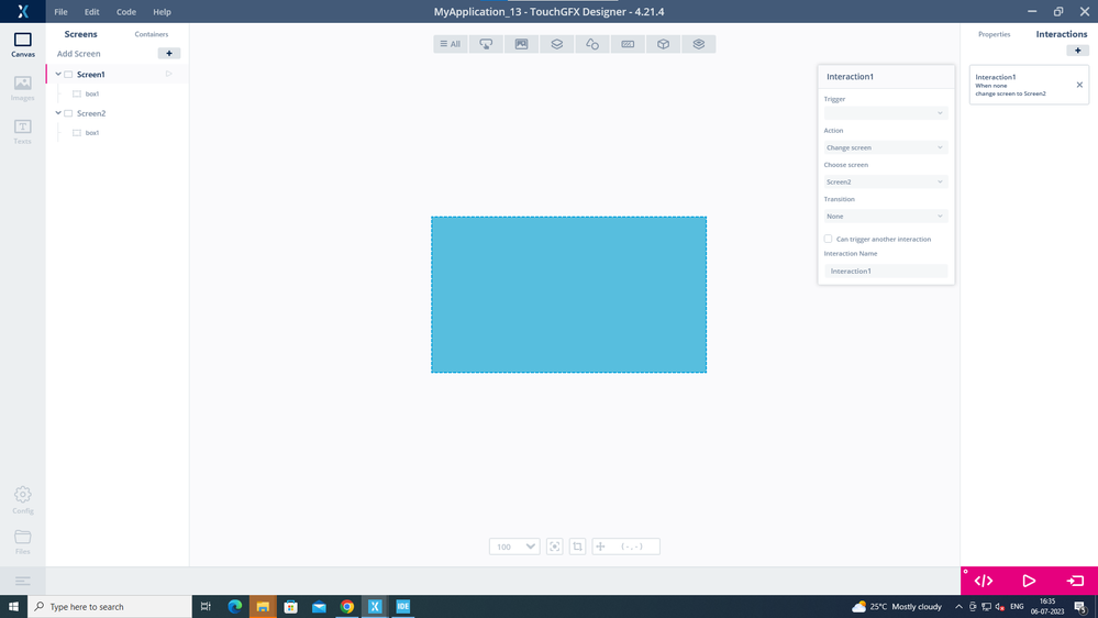

As suggested by the @t.decker I have tried with the interactions to change the screens. But the screen is not switching from Screen1 to Screen2.
When I have tried in the simulation only the box that I have added in the Screen 1 is seen in simulator.
And I have not added any interactions or actions in Screen2.I have added an action and an interaction suggested by @t.decker
