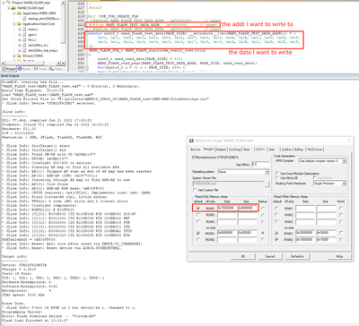

As I said above, I want to write data to Nand Flash extended by FMC by MDK directly.
After reading(LAT1198), I know an algorithm for Flash can program the data to extFlash by MDK.
I followed the steps one by one:
1. I created a project by cubeMx that can read and write the NAND flash normally by MDK;
2. I copy the template in the "ARM\Flash" folder and port the NAND flash driver to the template, it builds with no error and generates the FLM file, the code as below;

}3. I tested the FLM file, but the download always failed.
I don't know what details I missed led me to fail.
Could you help me, thank you!

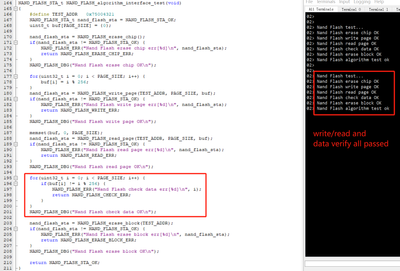

2024-04-07 10:22 PM
Thanks @Tesla DeLorean
I already checked the map file and the data at 0x70000000.
I also tested the interfaces that are used in FlashPrg.c, seems all the interfaces are passed:
I am helpless because I already tried all the things in my mind.
I want to debug it, but I don't know how.
Do you have any other ideas to check what I am wrong, thanks a lot.

2024-04-08 10:49 PM - edited 2024-04-08 11:16 PM
Thanks GOD, I find the way at last.
The key point is we can NOT use interrupt in the FLM file, so we must rewrite the HAL_GetTick() function:
