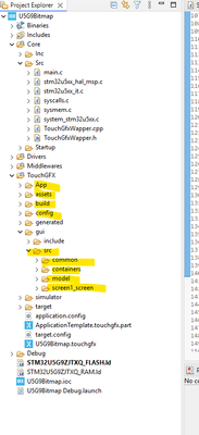

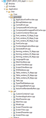

I will show you why I would love to generate the project from STM32CubeIDE instead of TouchDesigner/STM32CubeMX
STM32CubeIDE:
All TouchGFX stuff is displayed in folder and cartegorized nicely.
TouchDesigner/STM32CubeMX:
SUCH A MESS
Is there any workaround we can stay using CubeIDE (by this we mean to check "generate under root") so that we can keep that file structure?
