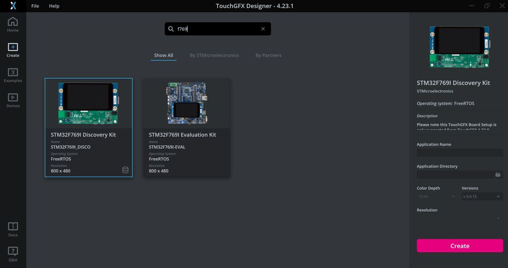

2024-02-21 5:15 AM
Hello @jr_engr_mbed ,
There is a Borad Setup available in TouchGFX Designer that you can use to develop you GUI easily. As our fellow friends @Uwe Bonnes and @mƎALLEm mentioned, SDRAM is required, however, the TouchGFX Board Setup has already set it up, so you don't need to do it yourself.STM32F769I-Disco Board Setup
About the 12 dynamic graphs, I suggest putting them in in separate screens and not in a single one, otherwise, the performance will be affected significantly. And, regarding the ECG waveforms, the format of the waveform depends on the value of the data that you add to your graph, and the process of handling external data is completely similar to the one explained in the video you mentioned.
Don't hesitate to ask more questions if you needed, good luck

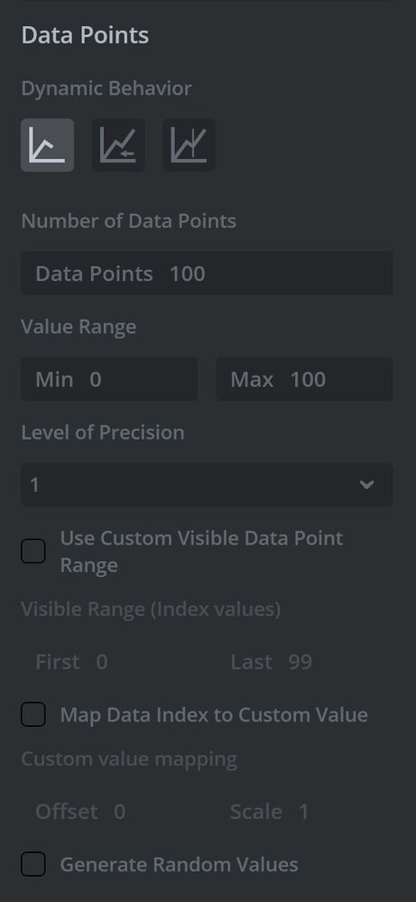

2024-02-23 3:00 AM
Thank you for your assistance. Now, I can display the waveform on the screen, but I am unsure how to eliminate the initial waveform that appears before the analog input starts. Please explain how to avoid this initial wave so that the analog waveform is displayed correctly from the beginning.
Additionally, how can I increase the amplitude of the wave? Where should I set this to ensure the waveform covers the full display?

2024-02-23 6:45 AM
Hello again,
For removing the initialized data, just remove the checkmark for "Generate Random Values" under the Properties of your dynamic graph.
And also, you can scale your graph by changing the Value Range in the Properties again.
Dynamic Graph Properties
You can read more about the Dynamic graphs and how they work here
