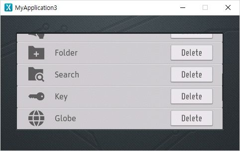

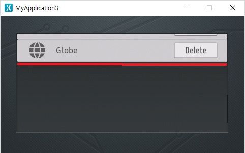

I am creating my menu using ListLayout Example of TouchGFX example code.
I want to set the Limit of the Scrollbar. But when I reviewed the current example and Class, I could not find that part.
How can I set Limit ?????
The end of the current list is similar to the one below, but I want to make the end of the list like the second one.
1st.
2nd.

Its like the scrolling limit value is somehow set to the upper side of the container instead of the lower side
