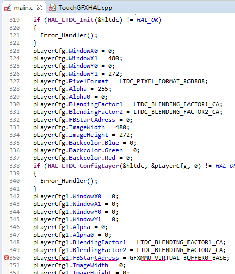

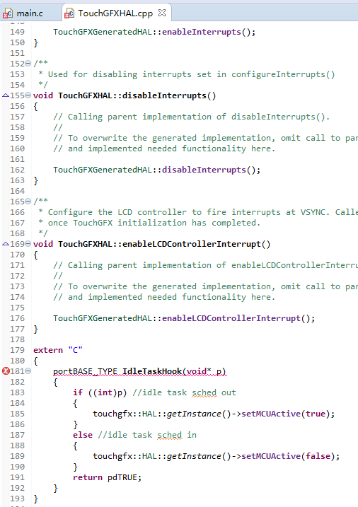

2020-09-10 6:24 PM
thanks for your answer.
And following it,I download an example for touchGFX designer, copy out the .ioc inside the project,
then unselect the freeRTOS and generate another code in cubeMX.
A question came out,as the pictures shown .
Hoping for your further advice.
2020-09-10 11:22 PM
You can delete the IdleTaskHook() function. This is used only when using FreeRTOS to know approximately the load (in percentage) of the MCU in real-time.
Therefore, you can also remove everything regarding MCUInstrumentation in TouchGFXHAL.cpp as well (usually at the beginning of the file).
For the GFXMMU issue, I need more info. What board are you using ? Do you have a round display ? What is written exactly for this error ?
