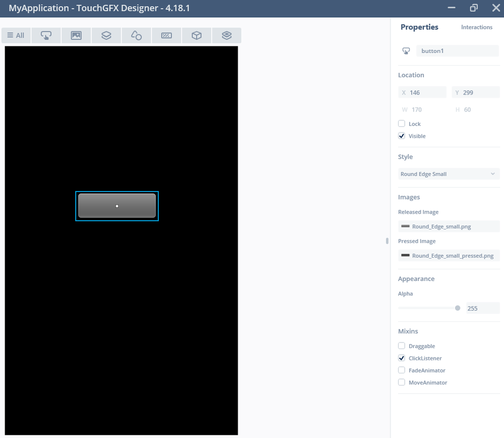

I didn't use repeatButton. But I also tried the repeatButton, it didn't work.
As long as the button is pressed, the LED does not stay on.

My electronic board is a custom board. I don't think there is a problem with the led control, because I can flash the led in other algorithms. There are 10 different screen views, dozens of buttons, pictures, etc. in my project. My software is almost finished.
In the pressed routine, I tried not only led but also relay and register control. The problem is always the same. When the button is pressed, it enters the Pressed routine, it works correctly, and the led turns on. But although the button is still pressed, the realeased routine runs and the led turns off. I think the problem is that it cannot detect that the button is still pressed.
