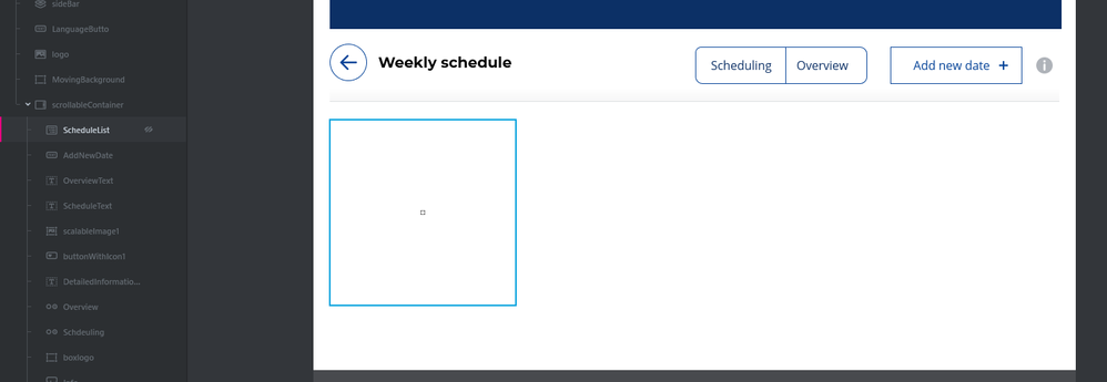

I've created list in my view window:

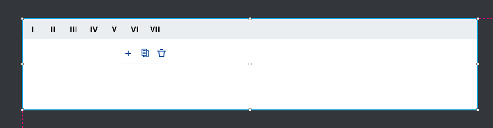

and by add new date I create elements in list. My custom container looks like that:

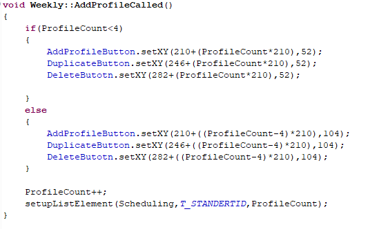

When I click plus button it calls this function:
How u see there is ProfileCount++; variable and I need to pass that value in to my view window. I ve tried to create object and by function pass index to my view but simulator always crashes when i do that. So maybe someone knows how to pass information from list elements?
