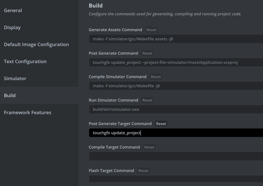

i use the STM32H757-EVAL Board and was already able to create a new project in TouchGFX (4.20.0), import it to STM32CubeIDE (1.10.1) and modify GUI and Hardware functionality.
In order to have more flexibility and to setup a more clean project, i wanted to create the initial project in the CubeIDE, add the TouchGFX Software Pack and only then start using the TouchGFX Designer for GUI creation.
My problem is now, that after generating the CubeIDE project and importing the "ApplicationTemplate.touchgfx.part" file in the designer, the code generation always fails.
The logfile says, that the post Generate Target is unable to locate the /.cproject file.
The file is located in the "Project_name/CM7" folder.
Modifying the Build setting of the "Post Generate Target Command" to the specific file location didn't help unfortunately.
Maybe someone here has also encountered this little problem before.

Ok i got the solution, at least kind of..
To your suggestion: i tried different commands with absolute and relative filepaths but none of them worked.
BUT: i found this 10 months old community question where the user seemed to have the same problem:
And it looks like the mentioned solution is still the way to go.
So i downloaded STM32CubeMX, set up a fresh project with the "Generate under Root" checkbox unchecked --> added the TouchGFX Software pack --> Generated the code --> opened the project in TouchGFX Designer and generated code --> imported the Project to STM32CubeIDE and there it was finally working.
Would be really great to have the ability in STM32CubeIDE to leave the "Generate under Root" checkbox unchecked in a future release.
But thanks for your help!
