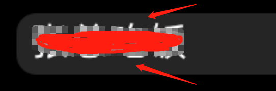

Assuming the height of the drawable object is H (getHeight()), and the height of text is TH (getTextHeight()), how to figure out the correct y value of the text object ??
I tried (getHeight() - text.getTextHeight() - text.getTypedText().getFont->getSpacingAbove()) / 2 and (getHeight() - text.getTextHeight() ) / 2, neither of them is right.

The calculation seems right to me. Can you show me, visually, what's wrong with your calculation?

It is obviously that, the up padding is different from down padding,
and I figure the padding through (getHeight() - text.getTextHeight() - fontSpaceAbove) / 2
2019-06-03 4:41 AM
The value is wrong !!! value of the getHeight() is 44, while the textHeight() is 34 and the fontspaceabove is 5, thus, the padding is (44-34-5) / 2 = 2, it seems wrong!!!

It was fixed, the true height of the text is text.getTypedText().getFont->getSpacingAbove() + text.getTypedText().getFont()->getMaxTextHeight()
