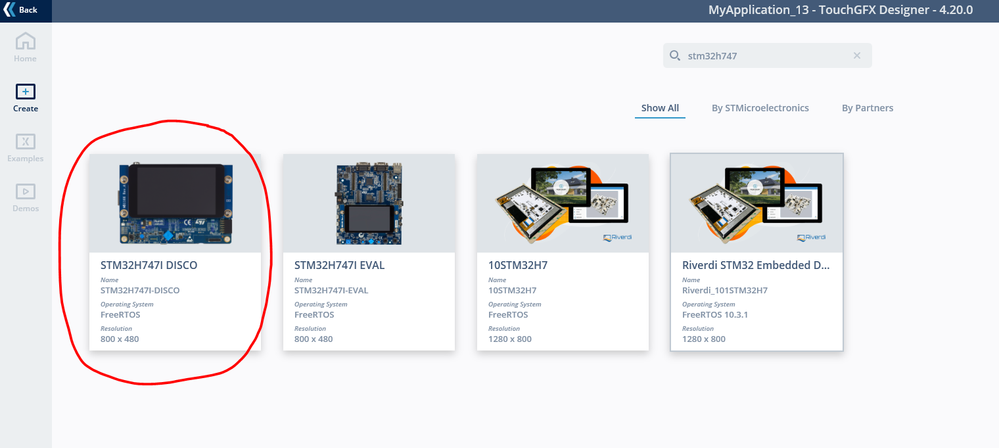

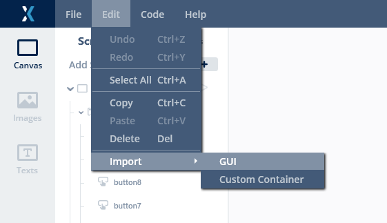

Hello @HNish.2 ,
You can create a project and select the STM32H747I TouchGFX board setup, and then import the UI you already created inside this new project. Then you will have the UI you want running both on simulator and on target.
Hope that helps,
/Yoann
