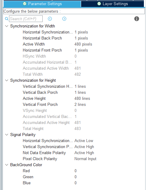

I am using the LCD_TFT STP480480_R021B2, with a framebuffer size of 480x480.

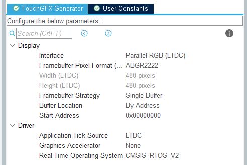

This is the configuration of my TouchGFX :
Here is ABGR2222, but it's barely the same.

2021-04-23 3:10 AM
Is the start address set at 0x00000000 intentional ? That seems really odd to me :grinning_face_with_sweat:

2021-04-24 12:16 AM
When you plan use internal buffer better choice is select Location By Allocation instead By Address.
Otherwise you need reserve memory in linker script.
2021-04-26 3:07 AM
As I work by address, and I define the framebuffer myself in the code, I cannot set the address in cube MX because it is the linker that decide it I believe. So I set it by hand to the LTDC and Touchgfx
I have also tried by allocation but there isn’t an evident way to indicate to the LTDC the start address of the framebuffer as the LTDC is initialised before touchgfx in order for it to work.

2021-04-26 10:30 AM
STM32F429I-Discovery & BSP: problem with LCD and transparency
here example image with internal RAM by allocation, ofcourse you can use by address but here you need know how you do this.
