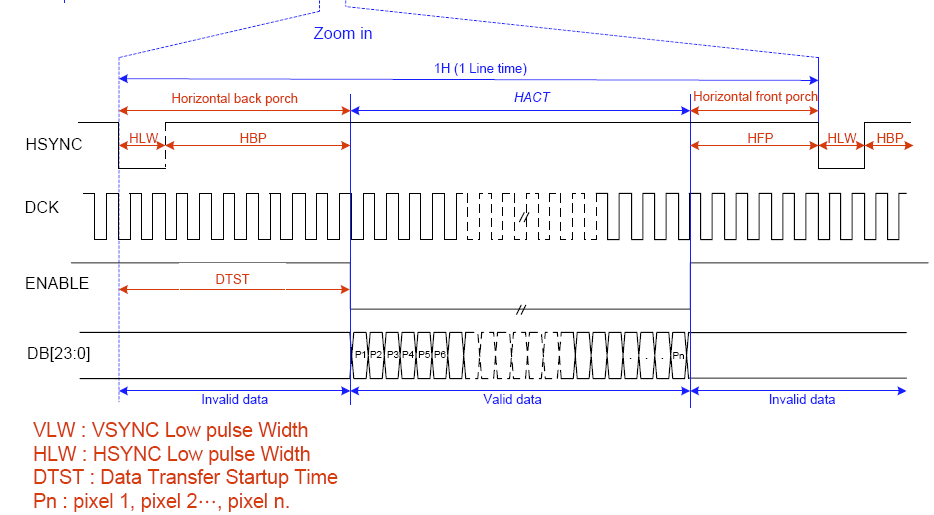

Check your PCLK DE and SYNC signals polarity with pdf
2021-11-10 10:08 AM
Startek signal names are confusing. So I checked them many times yesterday. Comparing scope capture and Startek pdf (below), it looks right.
