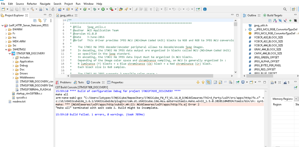

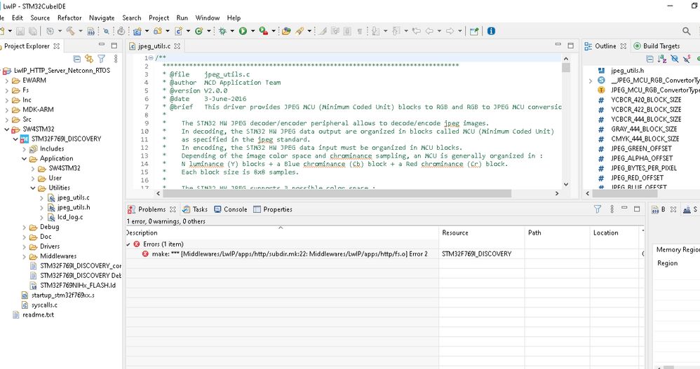

Good afternoon. I made a working project on CubeIDE for a railway timetable (LWIP, FreeRTOS, DSI, HDMI). The project was created in the repository. But the management has a requirement to add a symbolic part (JPG or bmp image). There was a problem when docking the JPEG part to the project (Error 2). How do I remove the problem? With respect. Alexander
2021-05-28 5:49 AM
Switch to the Console tab to find out more information about the error.

Good afternoon, Houda. The problem occurs when attaching a jpg part to the project. This situation can be replicated with CubeMX. If you add a JPEG part to the FreeRTOS and LWIP project(http available!!!), respectfully. Alexander.
2021-06-03 2:34 AM
Have you tried doing a 'Clean' first before 'Build' ?
Please copy & paste the Console output as text - so we can see it all
