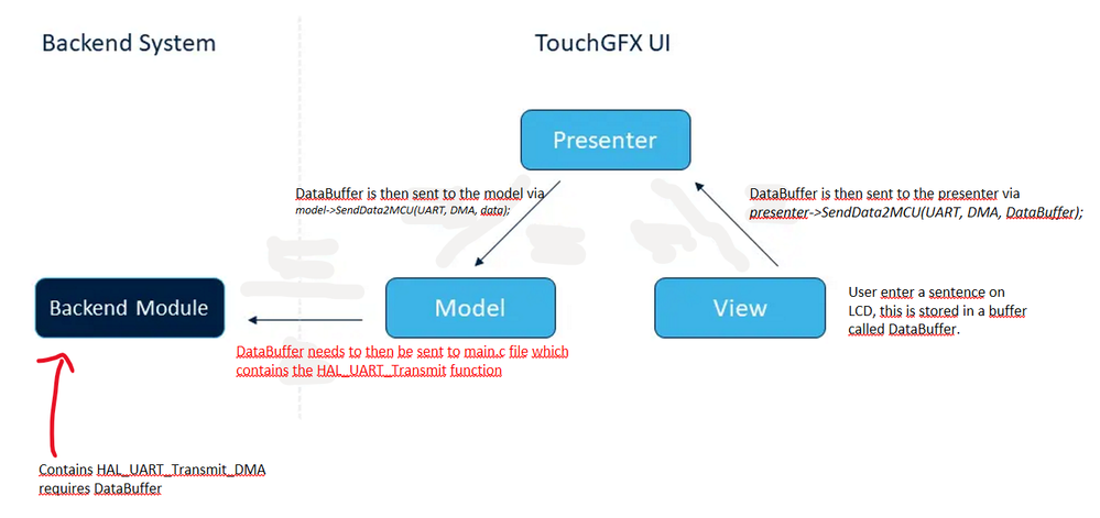

I have added a picture which represents how touchgfx LCD works with the backend module (main.c). The text in red is what's missing for me. I do not know how to send the function SendData2MCU from model.cpp to main.c file.
What should I write? main->SendData2MCU ?? This does not work...
