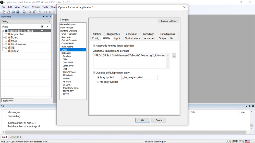

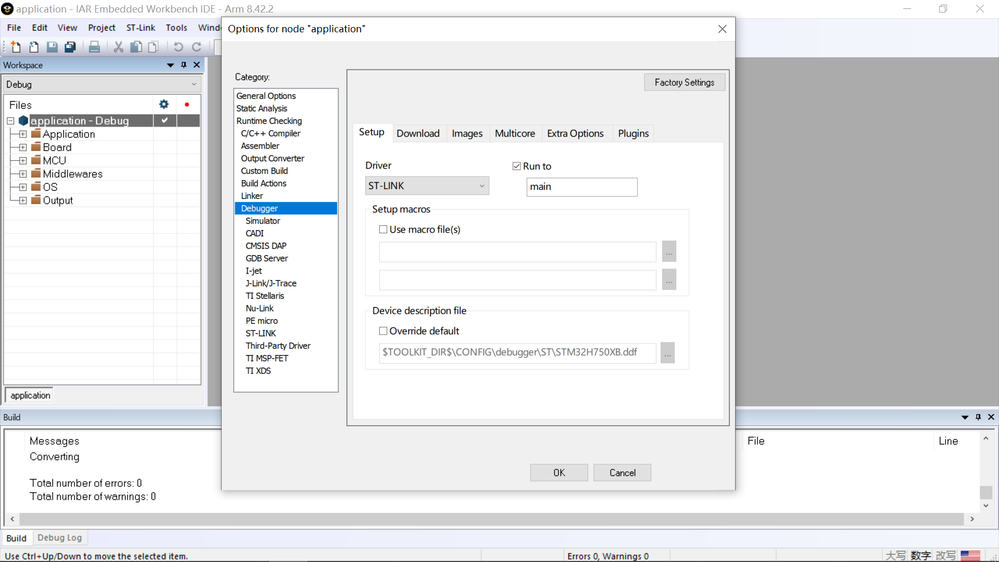

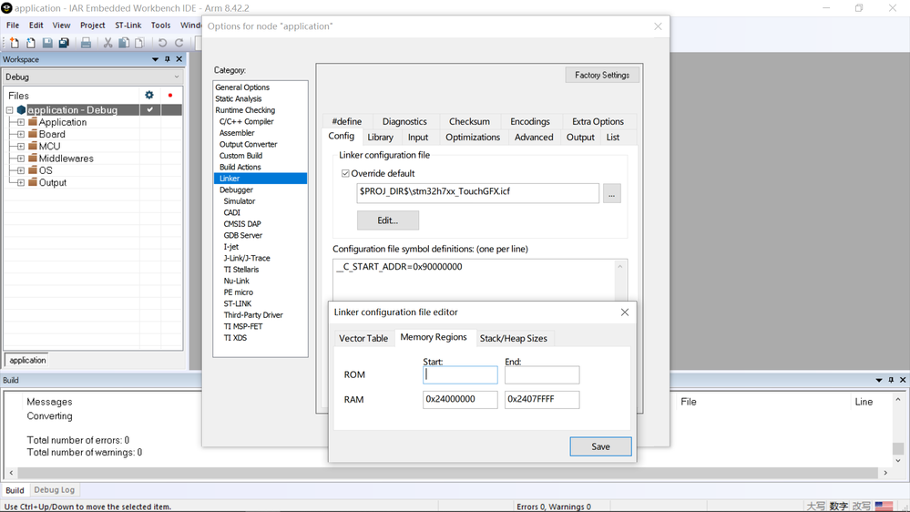

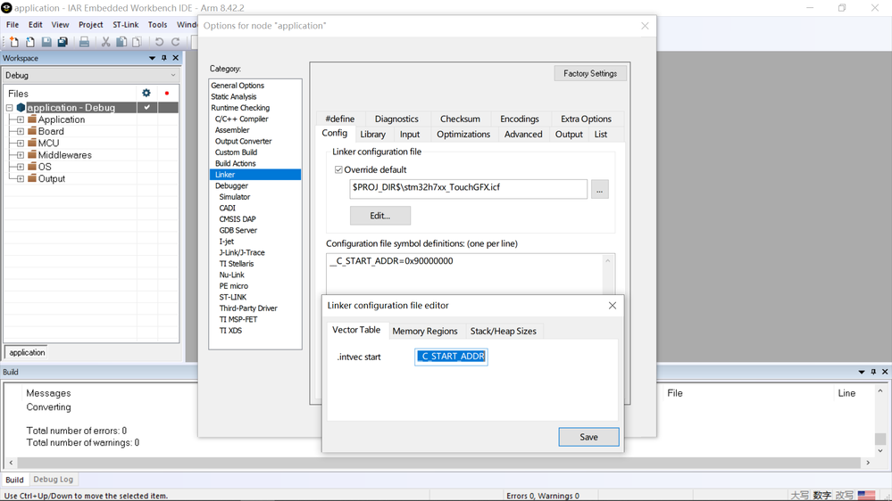

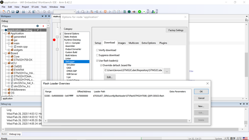

The settings of the IAR below.

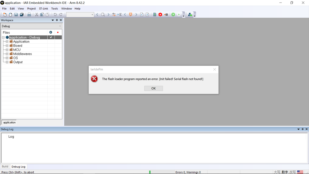

It compiles ok, but download failed, it show me that.
Thanks for your attention.

The way to debug using IAR is to build your project on IAR, then using STM32CubeProgrammer download the generated .hex into your board making sure you selected the right external loader.
When the download is successful, disconnect your board from STM32CubeProgrammer and try to run debug mode on IAR.
IAR usually can only download code and data into the internal memories (from what I experienced). Therefore, if you use external Flash for example and you have assets that are supposed to be stored in an address space linked to the external flash accessed via QuadSPI, IAR will not be able to download these assets into the board. That is why we use STM32CubeProgrammer because this software can program both internal and external memories.

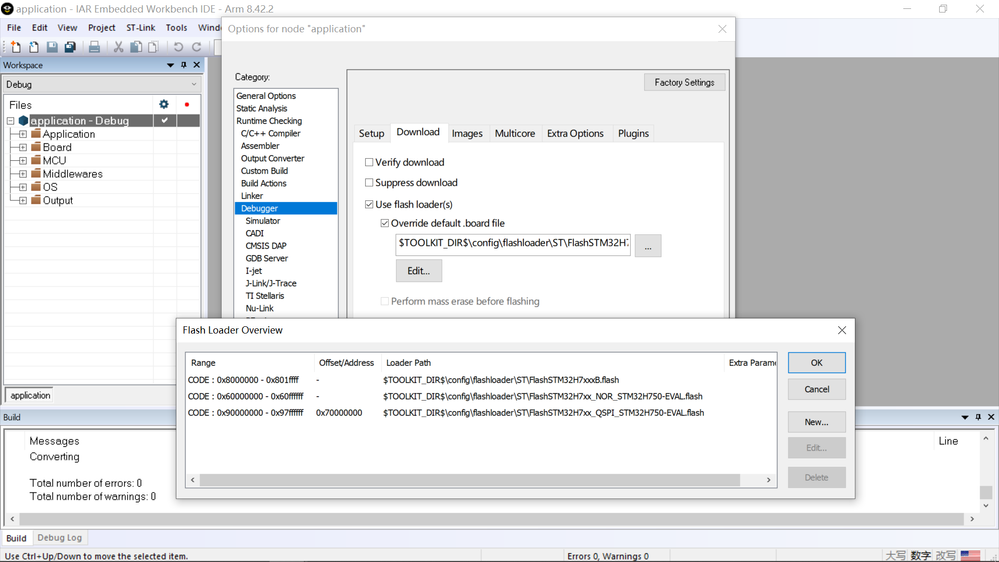

Not an IAR user, but check if there is a DISCO rather than EVAL external flash loader algorithm. The boards are usually wired differently.​
N. SANTINI
Please be aware that some patches (board scripts) are needed to use properly IAR with the H7 family, could you please confirm that you installed the following :
STM32Cube\Repository\STM32Cube_FW_H7_V1.6.0\Utilities\PC_Software\IDEs_Patches\EWARM\EWARMv8_STM32H7xx_Support_V1.1.zip

Like this one?
STM32Cube_FW_H7_V1.5.0\Utilities\PC_Software\IDEs_Patches\EWARM\arm\config\flashloader\ST\FlashSTM32H750B_QSPI-DISCO.flash
STM32Cube_FW_H7_V1.5.0\Utilities\PC_Software\IDEs_Patches\EWARM\arm\config\flashloader\ST\FlashSTM32H750B_QSPI-DISCO.out
>>I installed the support package, but still can not download the source code to QSPI Flash.
Unpack the patches, or look where you put them
...\EWARM\arm\config\flashloader\ST\FlashSTM32H750B_QSPI-DISCO.flash / .out

I unpack the patches and copy ​FlashSTM32H750B_QSPI-DISCO.flash and FlashSTM32H750B_QSPI-DISCO.out file to C:\ProgramFile(x86)\IAR Systems\Embedded Workbench8.4\arm\config\flashloader\ST.
Also I choose the FlashSTM32H750B-DISCO.Board (path:STM32Cube\Repository\STM32Cube_FW_H7_V1.6.0\Utilities\PC_Software\IDEs_Patches\EWARM\EWARMv8_STM32H7xx_Support_V1.1\arm\config\flashloader\ST ) on options->Debugger->Downloader.
The settings is that.
I can download and debug the source code via IAR now.
I want to know if the settings is the same or not for user custom board with the same address for QSPI Flash,but the QSPI Flash is different from the QSPI Flash(Mircon MT25QL512ABB) on stm32h750dk.
