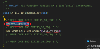

For example, when GPIO IRQ occur, it goes to EXTI15_10_IRQHandler().
UpdateDisplay() is called in it. This function is implemented by user, and used when updating minite string on LCD.
After UpdateDisplay() is called, it goese to Screen1ViewBase::updateMinuteString(). This function is generated by TouchGFX as an action. When it is called, update minute digit string.
