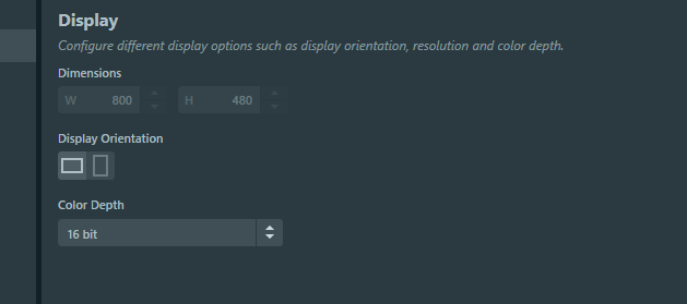

When I created the TouchGFX project, I set it up to 800 *480.
However, the LCD has been changed, so we have to change the things we have worked on so far to 854*480.
I am trying to change the resolution in TouchGFX, but the setting part is not allowed to be modified.
We need to change 800*480 to 854*480. If anyone knows how to do it, please ask

When you create project over MX you can change new resolution in MX and generate code. After this open ApplicationTemplate.touchgfx.part not touchgfx file.
OR ApplicationTemplate.touchgfx.part touchgfxfile is text file edit it simply before open ...

Hello PKunK.1,
This is normal because it is dependent on your hardware. Therefore, if you want to change the resolution of your project, you need to do it in CubeMX.

Are you working with a custom project or did you use a TouchGFX Board Setup for one of the ST boards available in TouchGFX Designer ? If you used any TBS you should have a .touchgfx.part file in the TouchGFX/ folder of your project.
Otherwise, as written above, you can open the .touchgfx file in Notepad or any other code editor and modify the resolution there by changing the value of the width or height.
If you are working with the simulator you should be able to modify the resolution in the Config -> Display tab in TouchGFX Designer.
