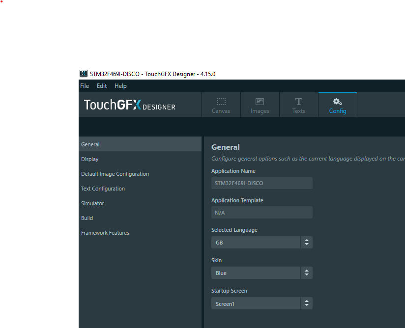

How do you change the name of the STM32F4 project that is generated by TouchGFX? I don't see an option to do it in the GUI of TouchGFX because the field for the application name is greyed out:
2021-01-28 4:41 AM
This is not yet possible within TouchGFX, but it will hopefully change in the near future.
