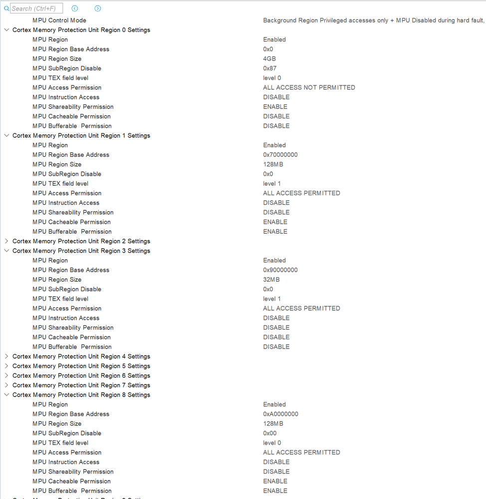

The problem with the HAL delay should be fixable by setting the time base timer to a higher priority. FreeRTOS intercepts the usual SysTick interrupt, but setting a timer as time base and setting the priority of that high enough allows the timer to drive the HAL ticks.
I was not aware you were running an H7S78. I think your original problem is probably related to MPU settings. For that template project, a base region is set up to allow no access to all areas, and regions are then set up on top of that to allow acces to specific regions. You should create a region for your SD address space with the settings used for region 1.
2024-11-28 8:15 AM
I believe we are almost here. Thanks.
So I changed the priority of the Timer and the SDMMC1 init now is ok.
I tried to also add a new address space for my SD (Region 8) according to the next image :
I can't see any image on the screen yet. The program is running without error.

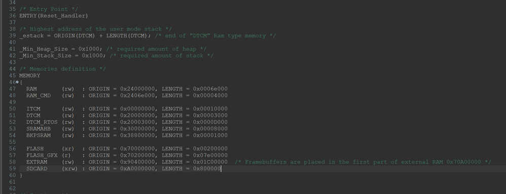

This is also my linker file :
Thanks for your help @mathiasmarkussen

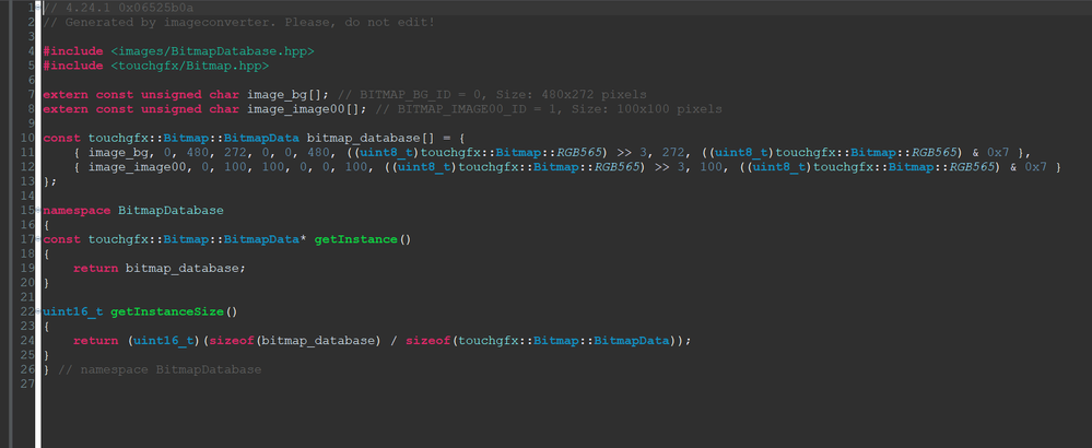

This is my BitmapDatabase.cpp file.
Thanks, I'll try your options.
In the video I can see that your colleague is using the (NOLOAD) option for the ld file, and then he use the command dump section on that section. How is it possible? that region should be empty so no dump could be possible. Am I wrong?
2024-12-02 6:22 AM
Please avoid code screen shots of your code and please use </> button to paste it instead.
Thank you for your understanding.
2024-12-02 6:24 AM
I'm sorry.
