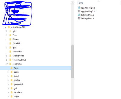

A) Hi HTD, having a problem with adding my required source/header files to a TouchGFX project.
B) When I build the prj with my "Makefile.mk" mods in TouchGFX Designer, I get the following error:
make[2]: *** No rule to make target 'build/MINGW32_NT-6.2/../../App/SettingsData.o', needed by 'build/bin/simulator.exe'. Stop.
C) I'm not a .mk file expert... Trying to add SettingsData.cpp and SettingsData.hpp to "App" folder by modifying "Makefile.mk" as shown below, see PJD MOD START and PJD MOD END:
Also, see below pic of my folder structure below...
Any assistance would be appreciated, Thk...
