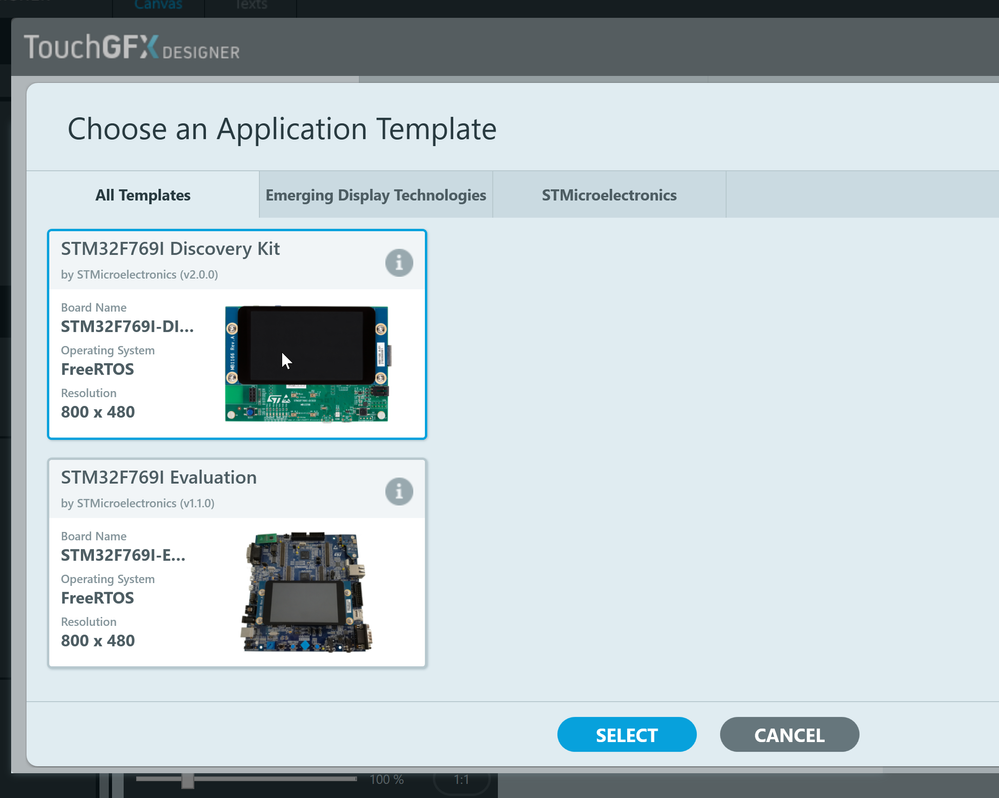

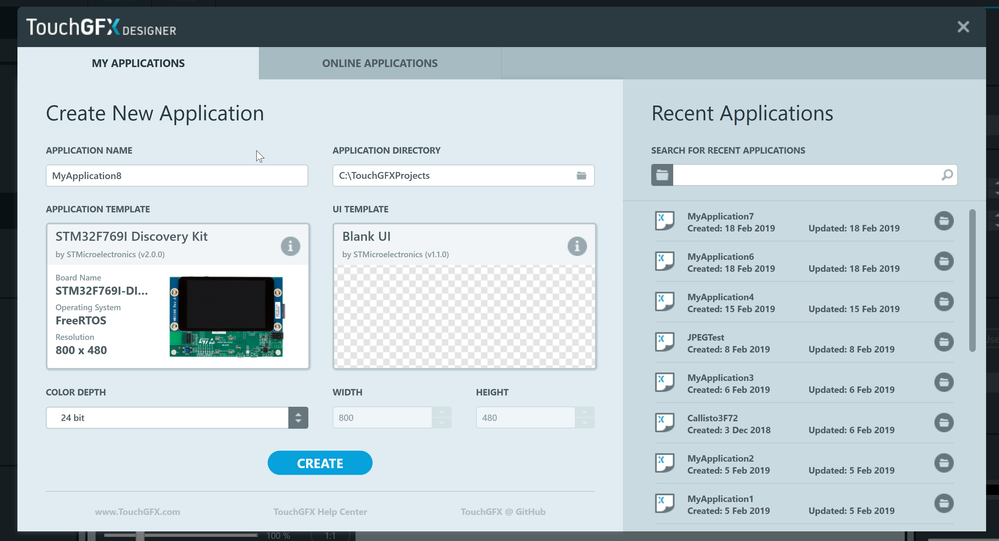

2019-02-18 1:50 PM
2019-02-20 7:39 AM
I will order the board to play, I hope to get it working. I would like to get for example the .ioc file becasue I want to add like ADC, I2C, DMA.
If I can send it to cube mx from touch GFX. Then I can finish in Keil.
But this is what I mentioned in my first post when I click on the icon generate code or save under file left top corner. Nothing happens. All application would open window to choose folder and file name. Here is nothing.
