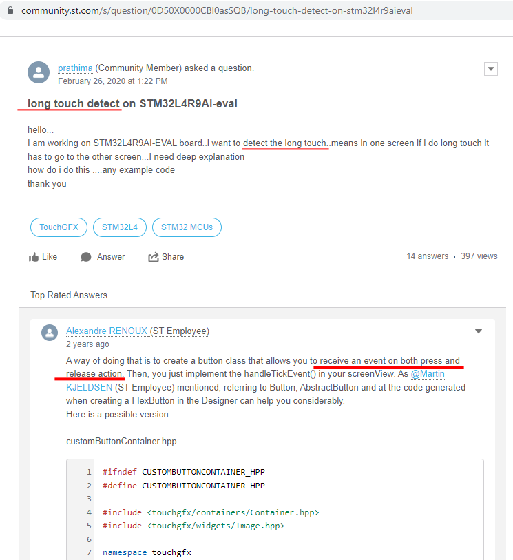

But that is exactly what the example that @Yoann KLEIN linked you to does:
https://community.st.com/s/question/0D50X0000CBl0asSQB/long-touch-detect-on-stm32l4r9aieval

I write below like this. But dont call handleClickEvent so dont get buttonPressedFlag = 1
void Ana_MenuView::handleClickEvent(ClickEvent& evt)
if(evt.getType() == ClickEvent::PRESSED)
buttonPressedFlag = 1;
else if(evt.getType() == ClickEvent::RELEASED)
buttonPressedFlag = 0;
void Ana_MenuView::handleTickEvent()
if (buttonPressedFlag)
temp_counter++;
Unicode::snprintf(textArea2Buffer, TEXTAREA2_SIZE, "%d", temp_counter);
textArea2.invalidate();

Did you read & follow the rest of the linked thread?
Particularly, "Look at how a Button and AbstractButton is implemented" ...
