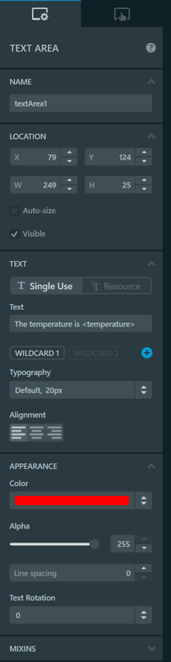

If you put the symbol "°" (or any other) in wildcard character, you can display it by displaying an UnicodeChar array. You need to implement the correct ASCII code: in this case, ° = 0x00B0.
With the settings and the code below you will display the following message : The temperature is 28 °.
Watch out: you need have a text area large enough to display the message, so removing auto size and increasing the width could be a good idea (in the Text Area tab on the right side of the Designer tool).
