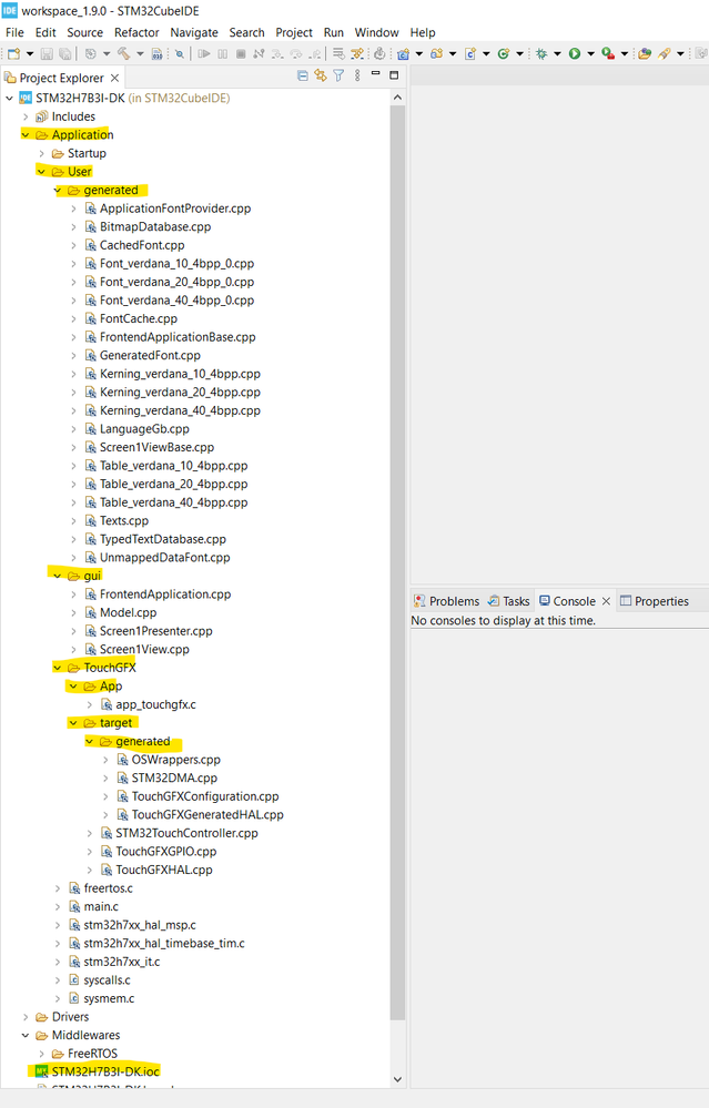

Hello again MMüll.6,
I do the 2nd way always, but I think you're missing one step;
- Start with TouchGFX:
  • Simulator works directly
  • Download with TouchGFX works

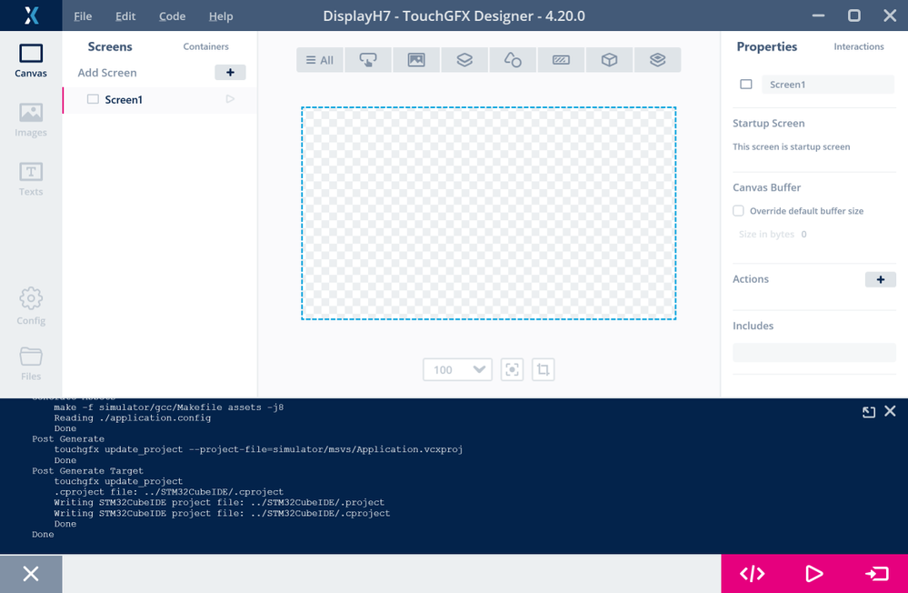

  • GENERATE CODE WITH TOUCHGFX DESIGNER (press F4)

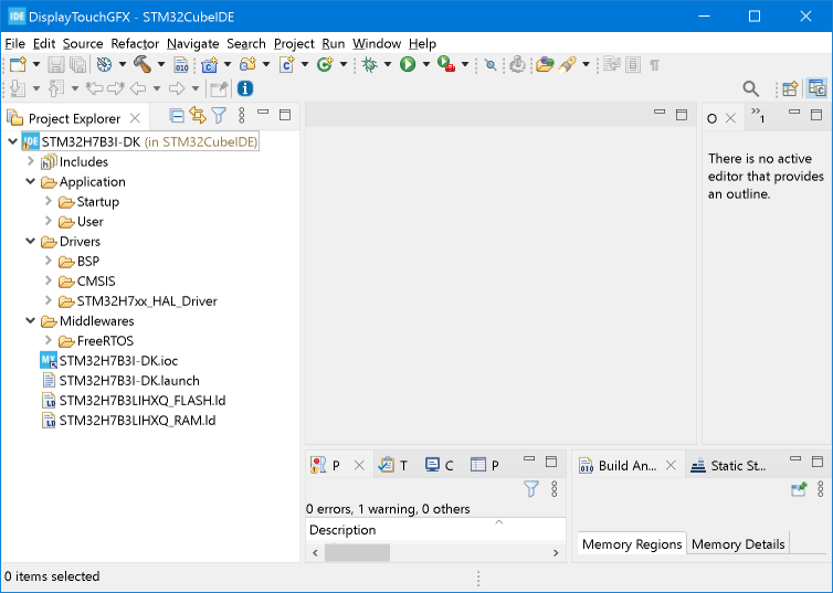

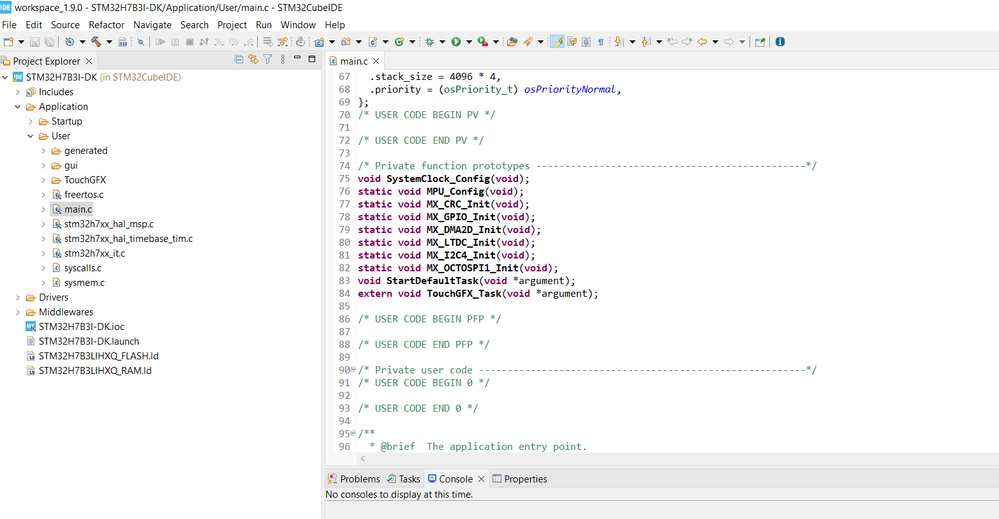

  • Open CubeIDE : it should work.0693W00000UnDLPQA3.png
  • All the TouchGFX generated files & user code are visible 0693W00000UnDN1QAN.png
Can you try that ?

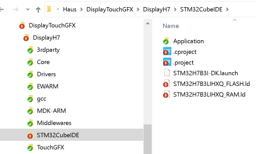

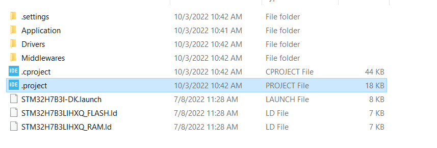

I have generate the code with TouchGFX designer:
0693W00000UnDSpQAN.pngIn the file explorer are the files, including the TouchGFX folder:
0693W00000UnDTTQA3.pngOpen the file ".project":
0693W00000UnDTdQAN.pngBut in this view I missing all TouchGFX files.
Here the auto generated code in attachment.
Thank you very much for help.
/Markus

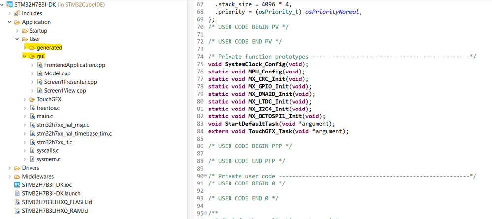

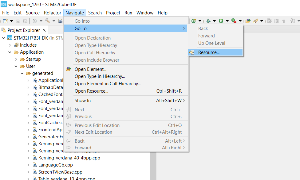

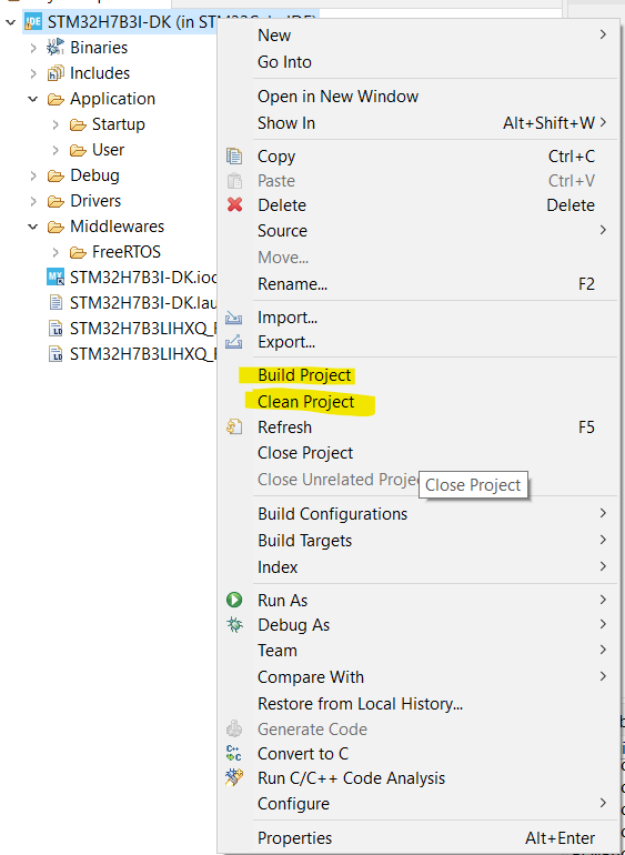

Nothing is missing :grinning_face_with_sweat:
I opened your project you shared, and I find all the files.
0693W00000UnENWQA3.pngI opened TouchGFX Designer, I regenerate code from there. Then in STM32CubeIDE, I cleaned the project (right click, "Clean Project"), then I built it (right click, Build Project"). No errors, no warning during compilation. So the project is working.

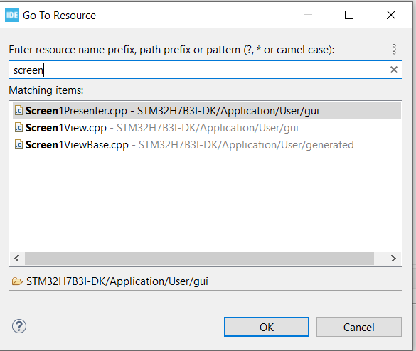

If you can't find a specific resource file in the tree, try to do a global search by its name like this :
